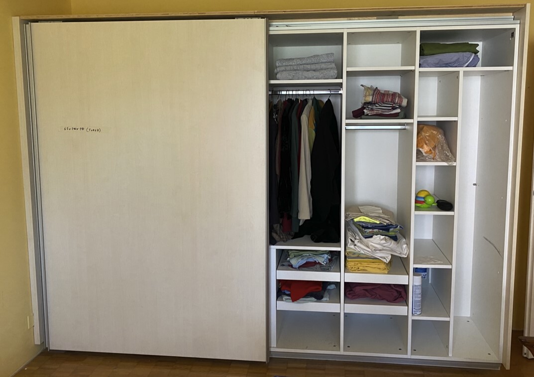

Maybe consider, instead of a sliding door wardrobe, installing sliding doors on the sloped wall and using that as a closet, and within that closet space create something like a bathroom (whatever kind of room that is). We were able to take over the sliding wardrobe from my mother. It was very expensive, and we thought about using it as a room divider.
This wardrobe, HxWxD: 210x290x65 cm (83x114x26 inches), won’t fit under the sloped ceiling. Behind it would be a completely unused space?! We’re planning a wardrobe along the knee wall with the doors about 110 cm (43 inches) wide in front…
The sliding door wardrobe is very large, with pull-out shelves, ideal for the adjacent bedroom…

We can’t fit this cabinet HxWxD: 210x290x65 (82.7x114.2x25.6 inches) into the sloped ceiling space. No, of course you can’t put a tall cabinet under an angled attic ceiling. My suggestion is based on building a custom fitted wardrobe under the slope—either DIY or by a carpenter—and then installing sliding door panels in front of it.

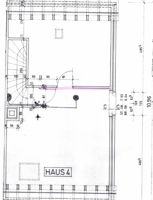

Having a complete floor plan of the level would be helpful. Take a photo of the knee wall storage area.

Attached is the total area of the attic. The wall marked in red was not built at the time.
The current small roof window would be removed and replaced with one of the same size as on the other side. So the bathroom layout is basically at the top of the plan?
It would be very helpful to have the height contours included in the overall floor plan, as well as the exact position and dimensions of the roof window.
Basically, I would try to place a wall along the 180 cm (6 ft) height line. To the left of the stairs, the shower could go there, then the toilet next to the "new" wall, and the separated storage space could probably also accommodate the drain pipe for the roof penetration. Then the sink could be positioned accordingly. But for that, we definitely need the above-mentioned details.
hanghaus20231 Nov 2024 19:30I tried to sketch something based on your distorted images. Placing a cabinet in front of the window is difficult. I have drawn the 2 m (6 ft 7 in) line. Your 1.8 m (5 ft 11 in) measurement cannot be correct according to the section.
@hanghaus2023 You placed the roof window in the bathroom area somewhat arbitrarily—right? According to the information, it should be located a bit further down in the plan because the small window was replaced with a larger one. At least, that’s how I understood it, which is why there was a request for the exact position and also the height of the bottom edge.
