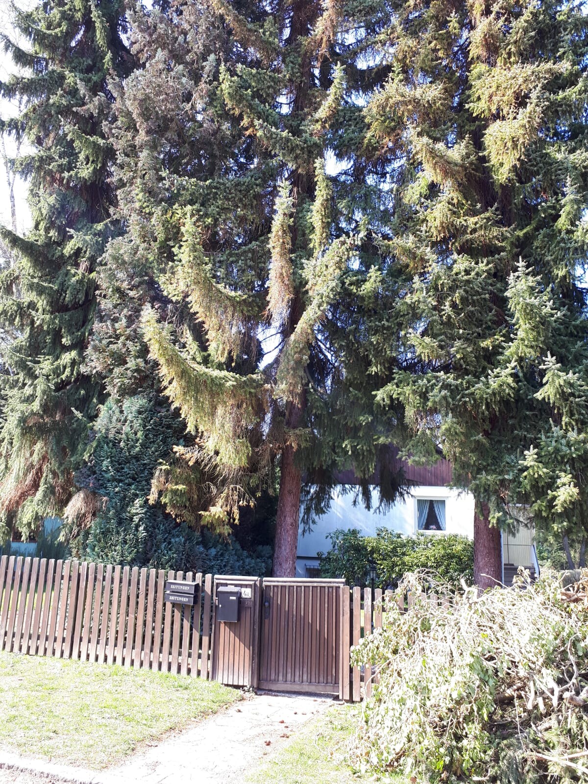

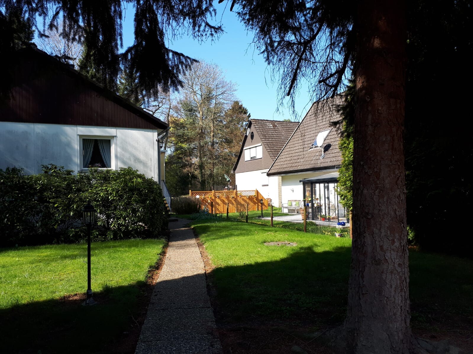

Once again – the trees at the front on the east side should be removed
View of garden path between two residential houses with trees and hedges
Garden view with tall pines, wooden fence and gate in front of a house

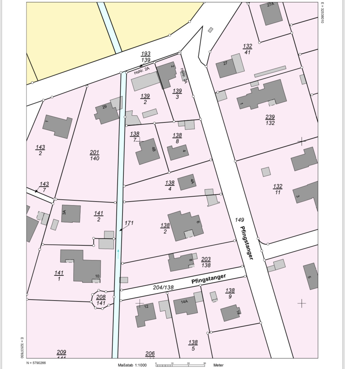

Escroda schrieb:
The neighbors to the north are definitely exceeding both limits. I also suspect three other plots. Therefore, I would give a good chance to obtaining a building permit exemption / planning permission waiver.
Which ones are you referring to?
Site plan of a building plot with parcels, buildings, and roads
E
Escroda
31 Mar 2019 23:40
Aloha1896 schrieb:
The entrance is from the east
This depends on how you interpret the building plan. I say the entrance is from the north. Well, you have to walk up the entrance stairs from east to west. But you actually enter the house from the north. In any case, the red arrow in #77 is incorrect.
Aloha1896 schrieb:
It hasn’t been very clear so far
Since I don’t really consider the mentioned contradiction in the building plan legally enforceable (whether legally or pragmatically I leave open) and I am not familiar with the texts related to the building plan, I assume that the floor area ratio is indeed 0.15.
Aloha1896 schrieb:
Which ones are meant?
138/7 and 138/8 as well as 139/3, 141/2, and 138/9 (visual estimate)
