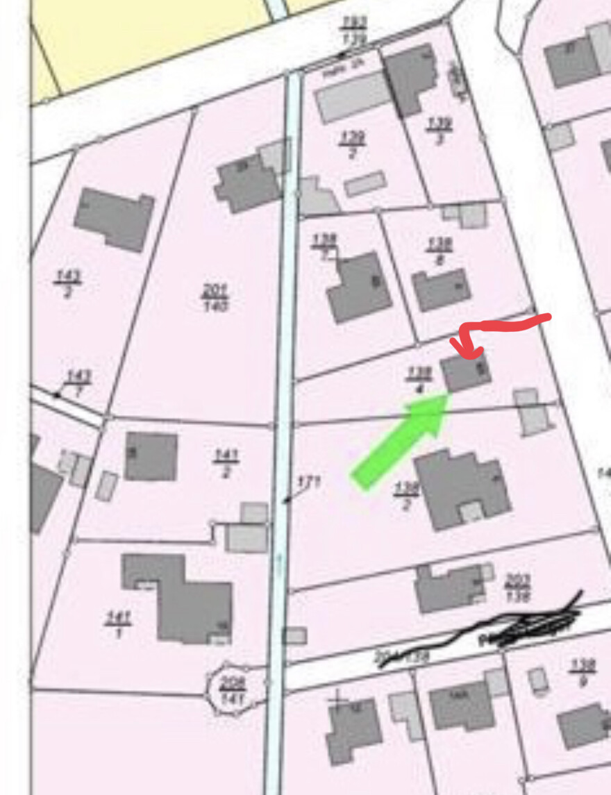

Hello, I have the opportunity to purchase a plot of land in the Hannover region with an old Okal prefabricated house. We would remove the existing house and potentially use the existing basement (which is dry). Now the challenge – the development plan specifies the following: II, floor area ratio 0.15 in the WR zone – the plot is 926 m2 (9,965 sq ft) and faces west – which results in 139 m2 (1,495 sq ft) – is that correct?
We are a young modern family of three and can imagine living in a small house. However, I currently have no idea how much net living space would remain, nor how the house could be designed.
Can I get some ideas here? Are there similar cases? I am attaching the current basement plan.

Aloha189631 Mar 2019 23:51Yes, from the north 🙂 the entrance from the east through the west to the north (current entrance) – a true tri-border point 😉

Aloha18961 Apr 2019 09:29So, now there is clarity – a floor area ratio of 0.15 according to the regional authority (although they themselves don’t really understand it).
