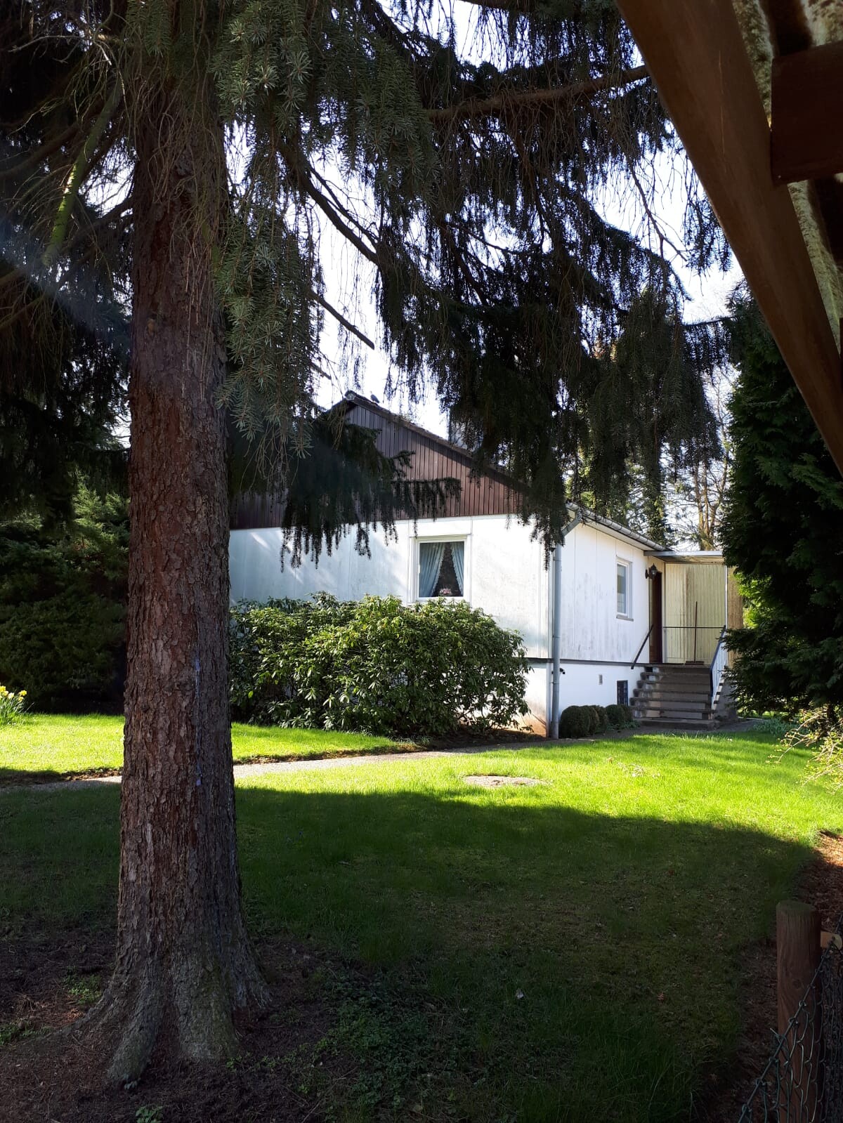

White detached house in the garden with steps and large trees.
So, now onto number 61 😉 sorry
The entrance faces east — here are a few more pictures (east view)

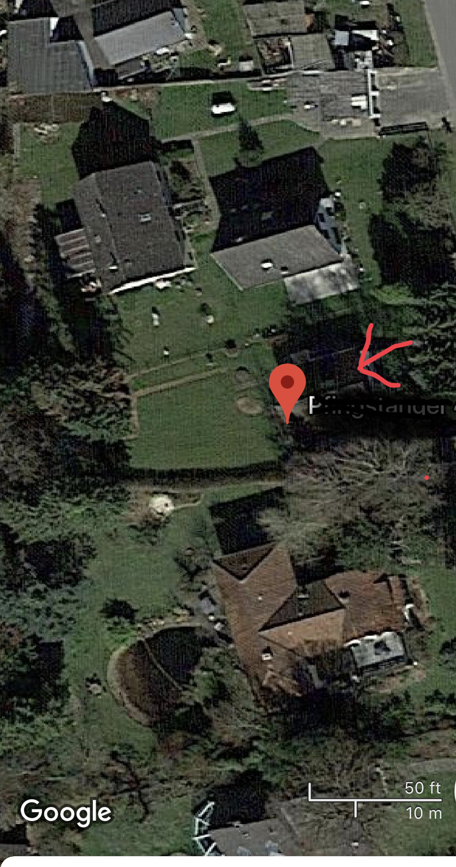

Aloha1896
31 Mar 2019 21:40
So, now to number 61 😉 sorry
The entrance is from the east — here is another picture – the entrance is marked in red
Satellite image of a residential area with houses, gardens, and location marker
Aloha1896
31 Mar 2019 21:41
Here is a photo looking from the east to the west (entrance on the east side)
Front view of a small white house with a green garden and large trees.
