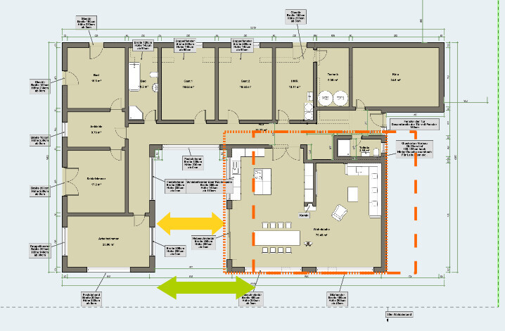

I find the half atrium too narrow in proportion and would therefore move the orange-marked area to the right according to the plan.
What do the dashed lines actually mean (there can be no alternative in a single-story building)?
