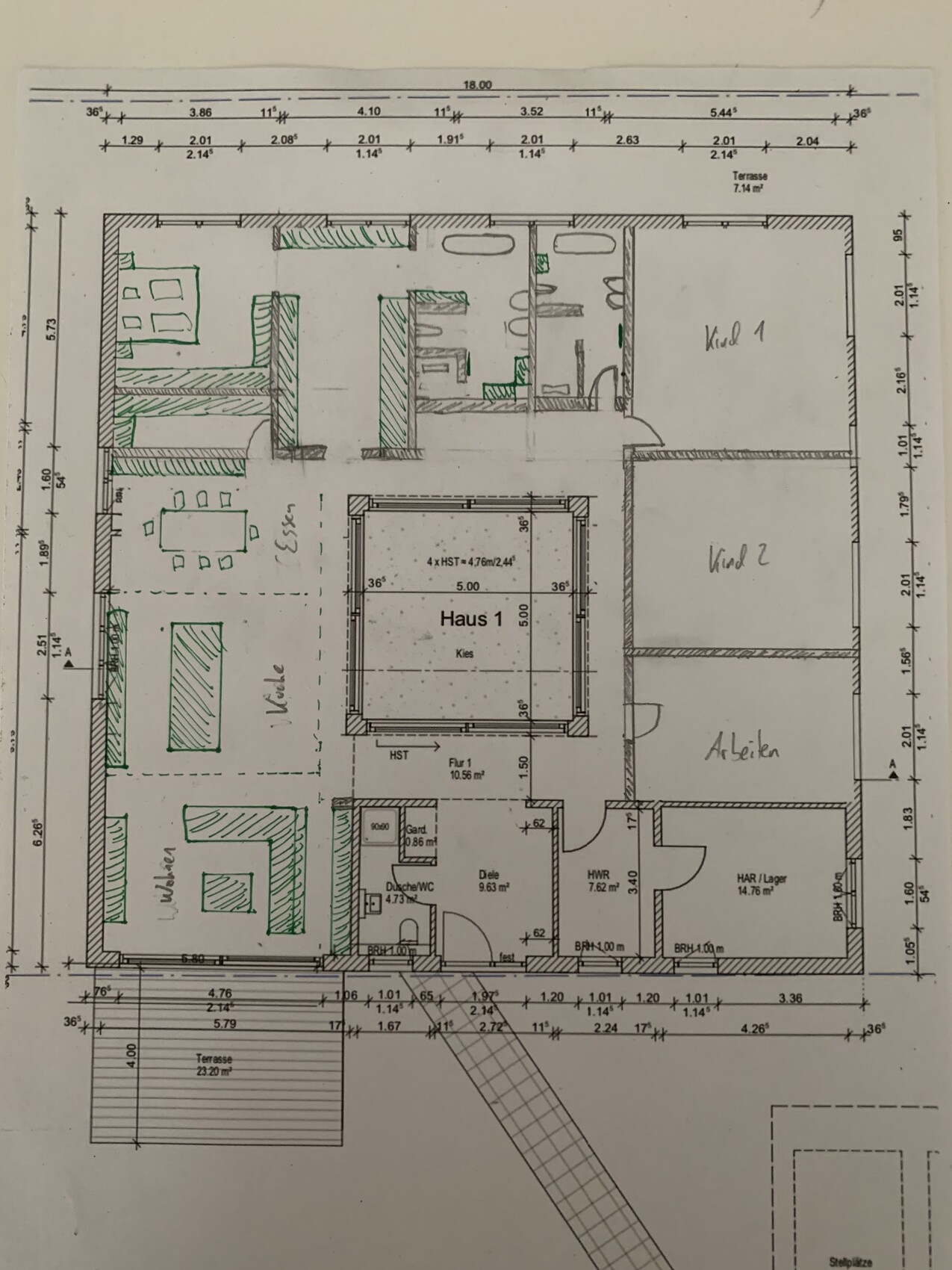

Floor plan:

Floor plan:

We basically like the shape, but I’m increasingly realizing that it’s rather impractical...
I quickly sketched an alternative. The kitchen in the center, the living and dining rooms on either side. The children’s rooms and office can be swapped depending on the needs.
A partial basement was once considered but was later dropped for various reasons (including the groundwater level and the location at the foot of a slope. Right behind the house, we have two well shafts that aren’t very deep, and about 150m (500 feet) further east there is a stream).
Hmm... then logically the dining area would also be in the center, meaning everything would be rotated around the original point. But then the pantry would be quite far away.
Actually, I quite like having the kitchen in the middle. It forms the center of the living area, and while cooking, you have a view into the atrium (whatever ends up being in there). A small dining space should definitely be included there as well.
