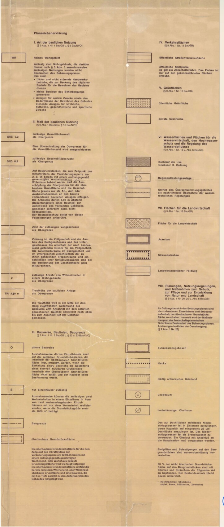

Building envelope: see attachment

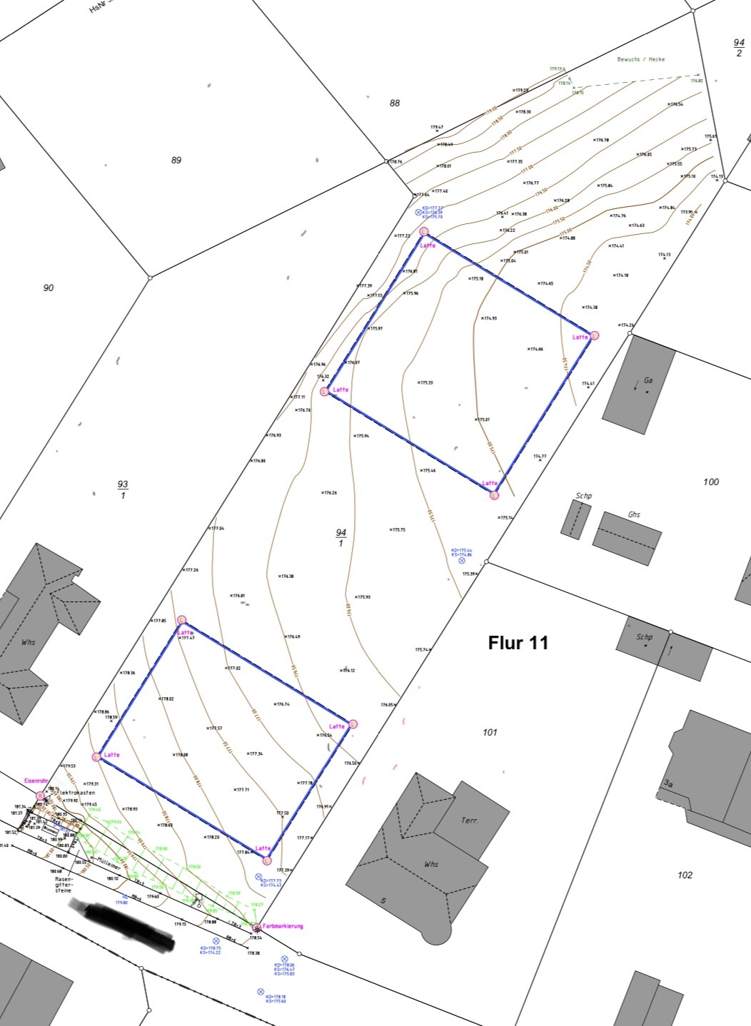

Contour lines:
Unfortunately, I cannot attach the PDF, but I hope the numbers are readable.

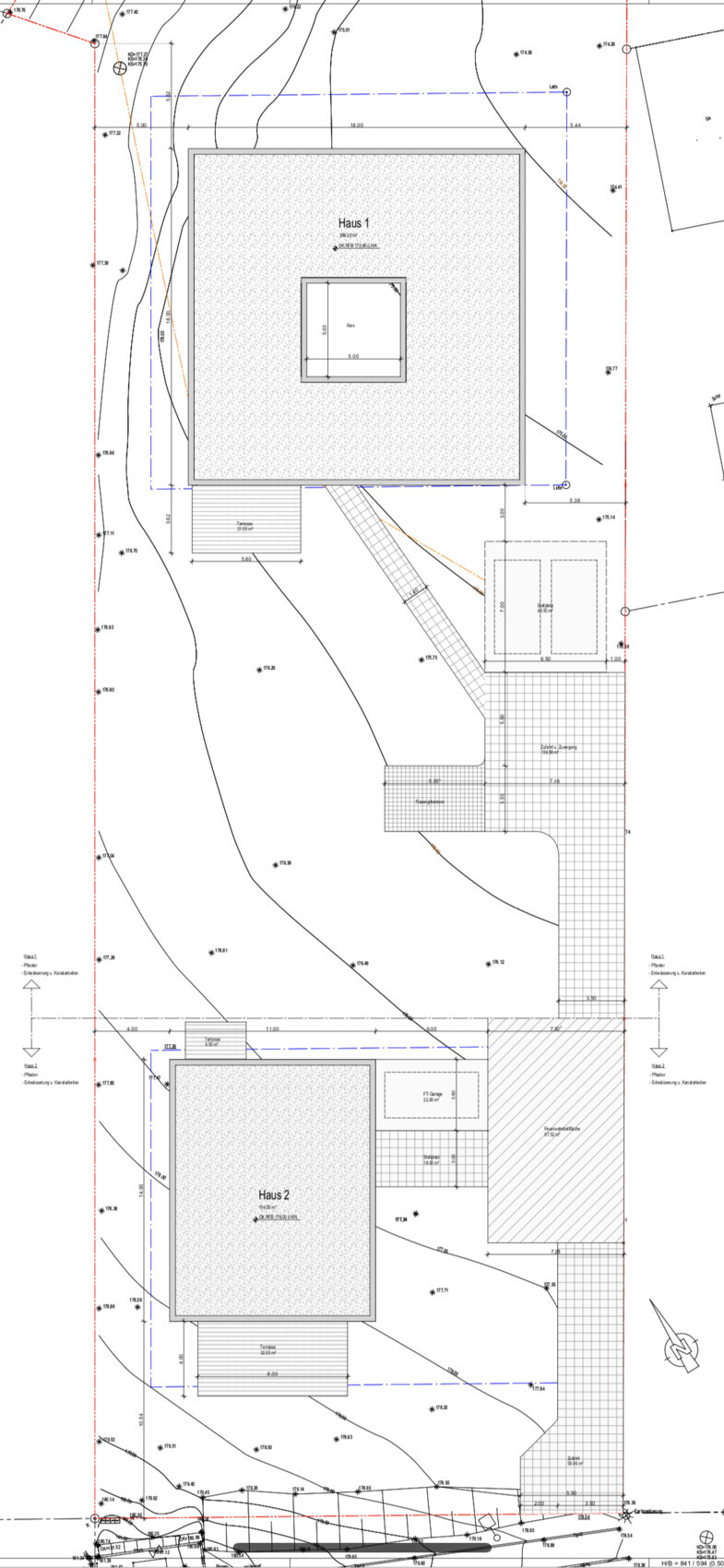

Open space plan:

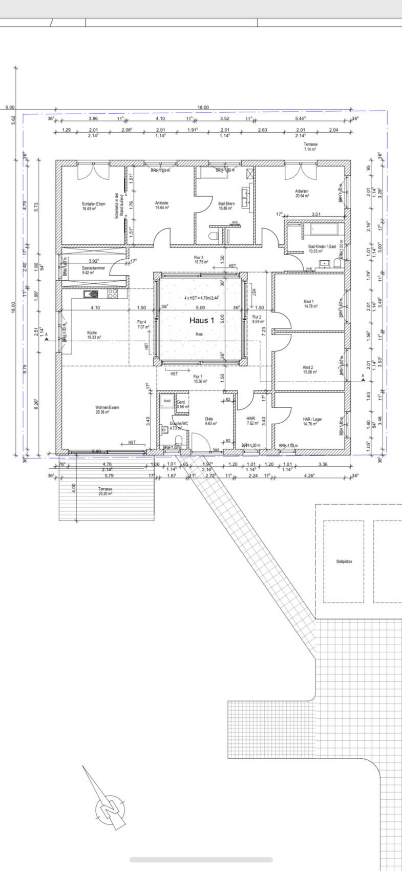

Floor plan:

Contour lines:

Obermuh schrieb:
In the end, we didn’t like that every room was always facing the terrace. Simple solution: instead of just window fronts, consider planning a wall sometimes.
haydee schrieb:
The idea of separate living wings works well for older children or just two people.
How about a covered atrium with a dining area in the center, from which the wings for parents, children, and living spaces would be accessed—possibly moving away from the square layout?That’s another option. Reduce the size of the atrium a bit, remove the corridor areas, and then have a glass roof over the middle. Wouldn’t a living room in the center (perhaps lowered by two steps?) make more sense than the dining area?
Simple solution: instead of just glass frontages, also plan for a wall sometimes.The nice thing about the Bien-Zenker U design is actually the large amount of glass facing the garden. Especially since the side views won’t be so pleasant (a slope on one side and neighbors on the other). If you open the U shape toward the back, the terrace ends up facing north. The garage also still needs to be placed somewhere in front.
Obermuh schrieb:
The nice thing about the Bien-Zenker U design is actually working with lots of glass facing the garden. Especially since the side views won’t be very attractive (slope on one side and neighbors on the other). The Bien-Zenker U should only serve as an example for you—no more, no less. It’s an alternative to your fixed idea of an atrium.
Good house design means using windows and walls purposefully, rather than just adopting everything that might not fit well on your property. Then there is the opening to the garden—the transition between house, terrace, and garden.
Who wants to sit in the shade of an atrium when the garden weather outside is perfect for enjoying time with family, caring for fruit trees, tending flowerbeds, and enjoying shrubs and blossoms? An atrium can help bring light into rooms and create attractive sightlines in a large house, but in my opinion, it is not practical for staying in for our climate zone. You can achieve good sightlines and natural light just as well with a modest U-shape or even an L-shape.
Fundamentally, you should consider how and where the entrance area fits with the terrace location and the main living areas. For example, I don’t see the Bien-Zenker U fitting well on this property...
Regarding the atrium again: in my opinion, such a space will sooner or later go unused, become an additional maintenance burden, and eventually be resented and neglected. The same applies to roof terraces that only serve as an extension of the garden—people tend to spend more time actually in the garden.
