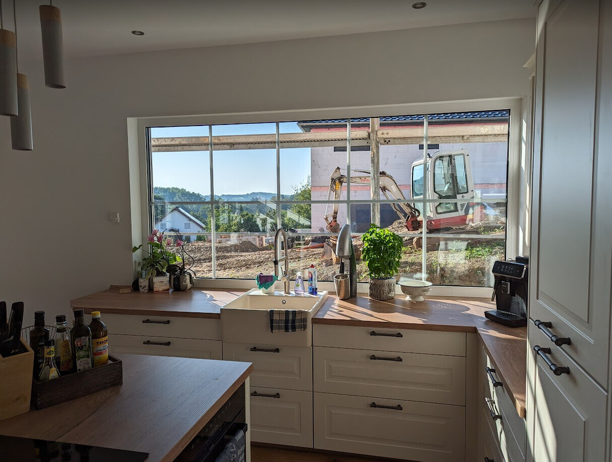

Windows above the sink with a nice view: DO IT.
We have a huge fixed glass panel on the sink side, and I would build it like that every time. We have been living here for about a week, and it’s a dream. The natural light in the kitchen alone is simply amazing. We haven’t had any issues with steam. We planned for a ventilation system in the kitchen (also a controlled mechanical ventilation system). So far, nothing has fogged up. It might also depend on how often you wash dishes by hand and how hot the water is. But besides draining pasta water, I can’t think of a time the glass would fog up.
Here is a photo of our panoramic view of our lovely excavator and our scaffolding.
