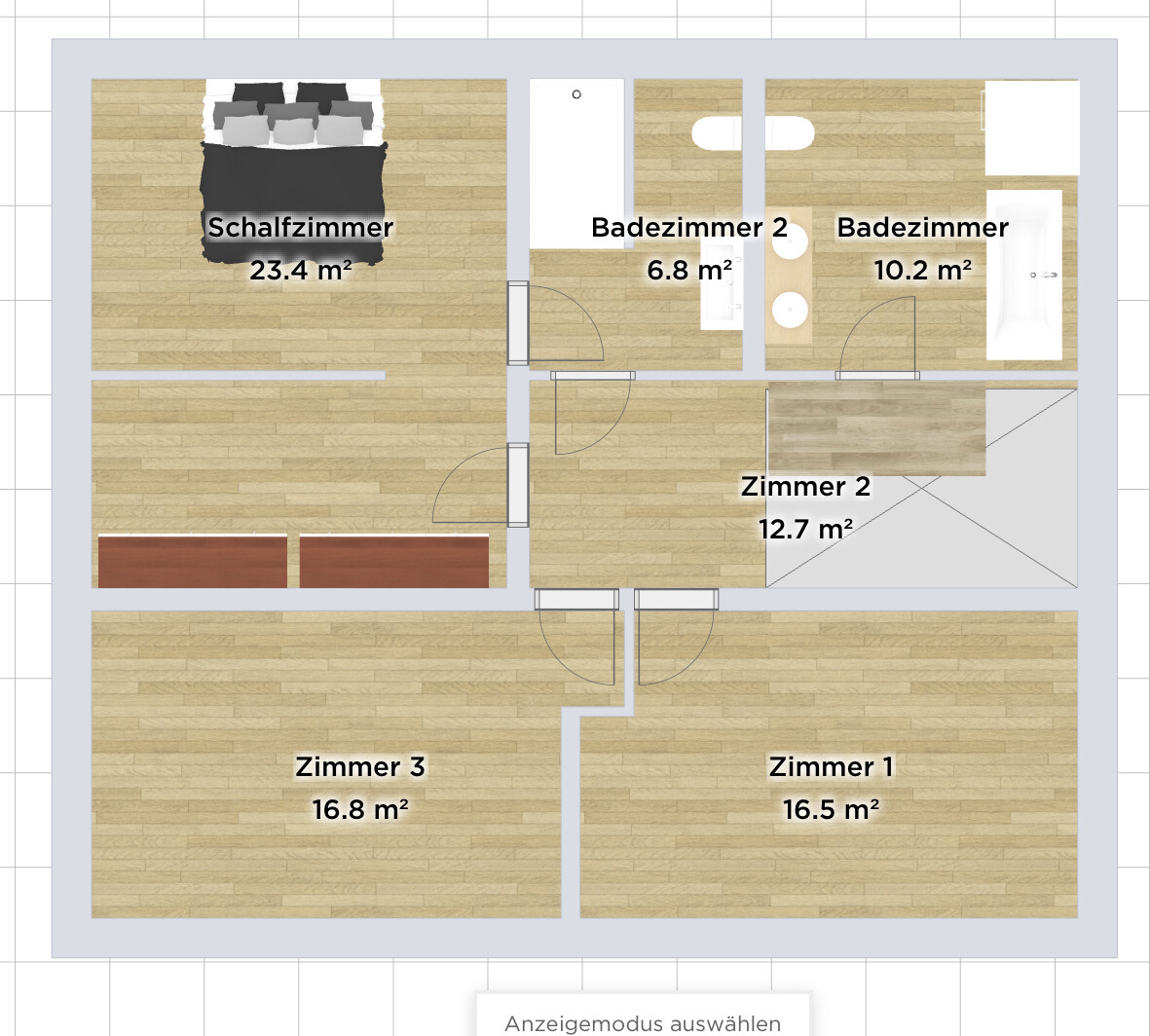

I have made an effort to bring some order to the plans, including the bathrooms. The measurements are not entirely accurate, as some rooms on the ground floor were only estimated.
Ultimately, I no longer have much patience, because when creating a hallway on the ground floor for the secondary apartment/wardrobe, I noticed that the tenant can not only walk into the wardrobe but could also access the entire upper floor, since the staircase is located in front of the basement stairs.
Therefore, I would strongly challenge the general contractor about what they were thinking.
Here are the corrections for the ground floor and upper floor (excluding the secondary apartment).
Upper floor plan: left living room with sofa, kitchen/dining area, staircase on the right, dark tiles.
Apartment floor plan: bedroom, rooms 1-3, and two bathrooms, including size specifications.

Thank you very much for the suggestions and the drawings. To summarize, you think that the granny flat, the pantry, and the bathrooms upstairs are not acceptable?
We are a family with two children.
We need to let this sink in first; the first phase from planning to approval took almost a year. I don’t want to wait another year and am considering whether it could be resolved with a modification.
Currently, no one would move into the granny flat; foreseeably, only one parent might.
