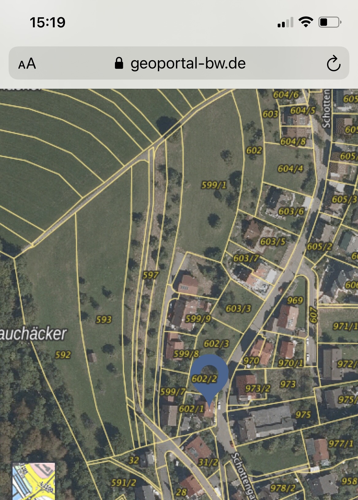

hanghaus20007 Jun 2021 15:15The land purchase is almost finalized.
We have not yet been in contact with the architect. He is only returning from vacation today. We have not had direct contact so far.
Here, the development plan is subject to a fee if requested from the city. I wanted to ask the architect about that. In advance, the city provided me with the data mentioned above.
602/2 is the plot number.
hanghaus2000 schrieb:
Are you referring to the small trees marked on the plan?
[ATTACH alt="Bild Grundstück.JPG"]62223[/ATTACH]
Is this the view facing south?
With a development plan, it makes sense why others here are building two stories.Yes, slightly towards the west.
On the phone, I was told that the properties across the street have a development plan from the 1960s, which allows for two stories. For our side of the street, the plan was created in ’89.
The responsible officer is on parental leave, and his substitute was rather young and annoyed. :/
