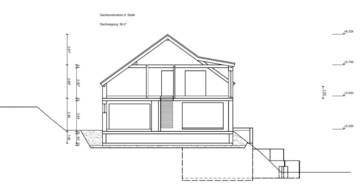

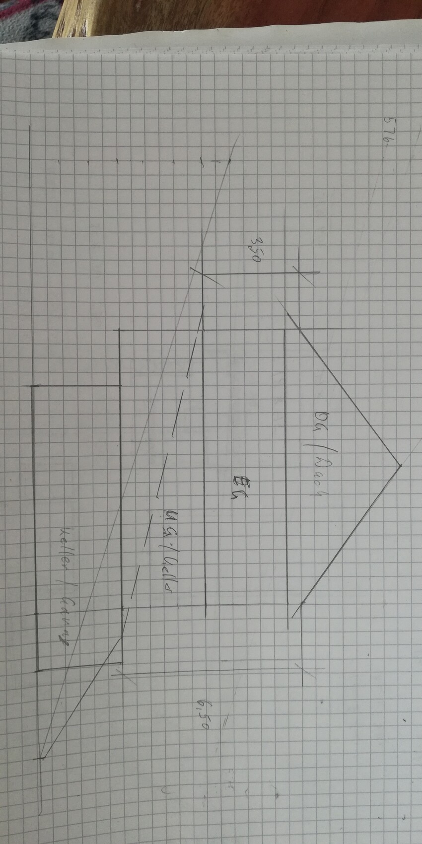

Is there a development plan now? I'll show it schematically. This is how it might possibly be according to the development plan.
[ATTACH alt="Schnitt6.JPG"]62234[/ATTACH] Planner’s sketch,
[ATTACH alt="Schnitt7.jpg"]62235[/ATTACH]
Sorry, I can’t rotate this?
In my opinion, this could be interpreted as a 1.5-story building. Depending on the lighting, the lower rooms could also be used as living spaces. That was our hope. Or lower the rooms so that there is more of the upper floor visible. I don’t know what the regulations are. I tried to read up on it, but it quickly becomes clear why I’m not a lawyer 😀
