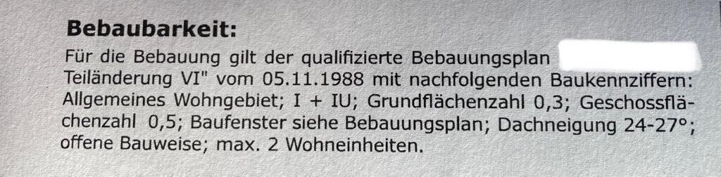

According to the development plan, a house with 1.5 floors, a gable roof with a pitch of 24-27 degrees, and no knee wall is permitted. We are wondering how this is supposed to work. Does anyone have experience with this and a solution to offer? We actually want to build a prefabricated house, not an architect-designed house (due to cost certainty).

According to the development plan, a house with 1.5 stories, a gable roof with a 24-27 degree pitch, and no knee wall is allowed.
I don’t believe that. There are no half stories, at least not in official building terminology and regulations. Just upload the original development plan. Otherwise, it sounds like a bungalow neighborhood. That works very well with a roof without a knee wall.
11ant12 Apr 2022 01:33
Eden1812 schrieb:
According to the development plan, a house with 1.5 floors, a gable roof with a 24-27 degree pitch, and no knee walls is allowed. We are now wondering how that is supposed to work?
Under these conditions, it will essentially be a single-story house, and converting the attic for living purposes (or more accurately, for sleeping or working) hardly justifies installing a staircase; I would only use the attic as a storage loft. I also share Yvonne’s assumption that this development plan is intended for a bungalow area.
Eden1812 schrieb:
We actually want to build a prefabricated house and not a custom architect-designed house (due to cost certainty).
What can I say about this recurring debate? – read around here for a while, and the belief in the marketing idea of a cost-certain “prefab” house will fade away. A 27° roof pitch won’t get any steeper, even with an architect ;-)

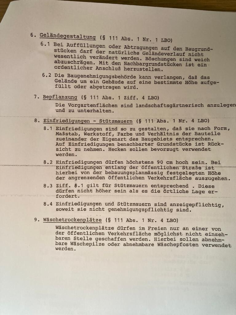

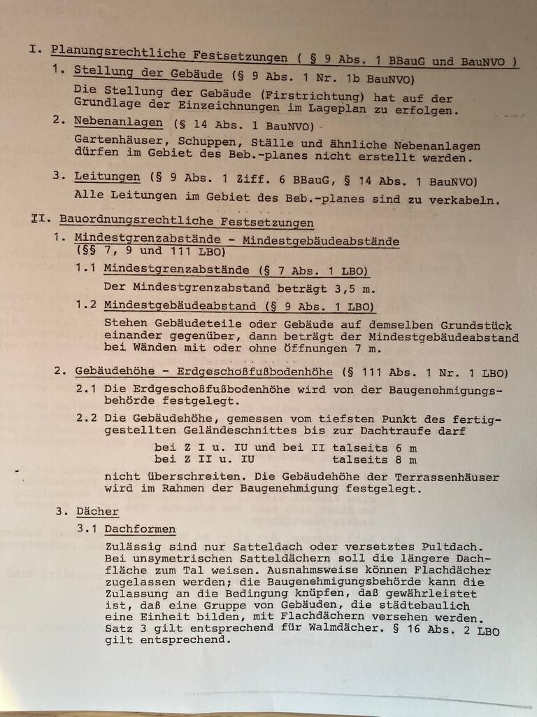

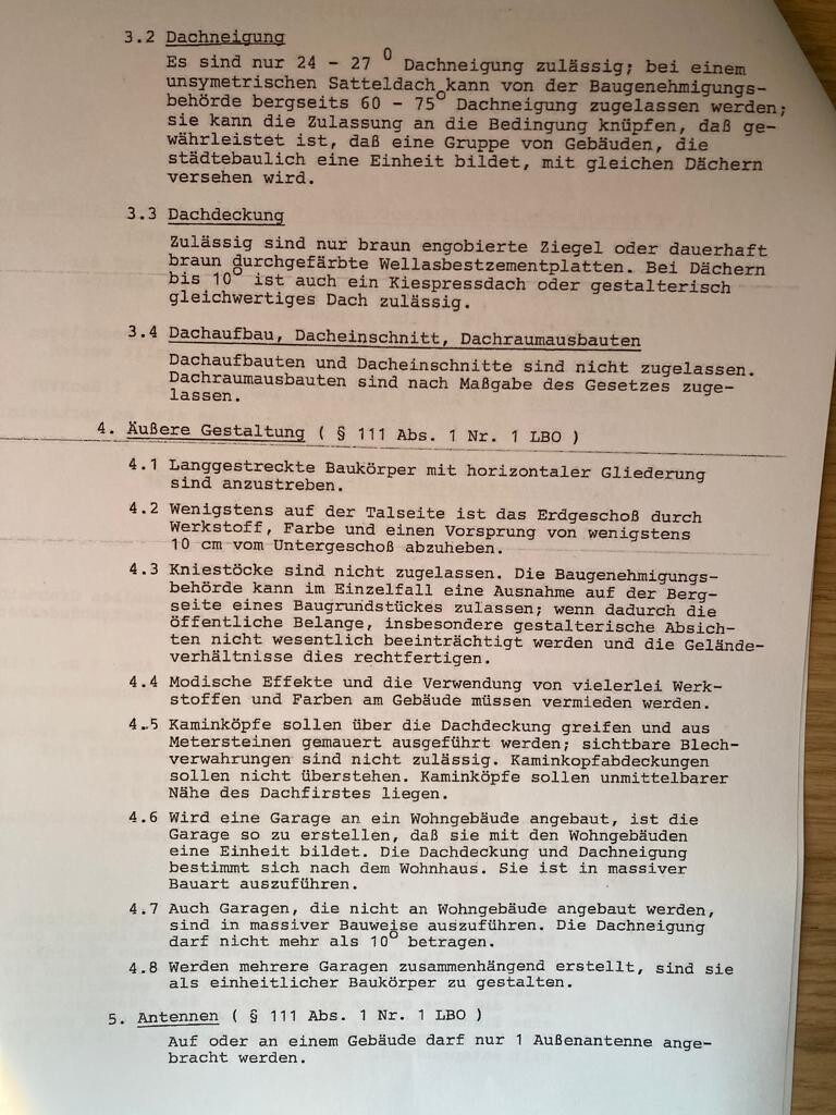

Hello everyone! Thank you for your responses. Attached is the zoning plan.
Printed page with sections on roof construction regulations (roof pitch, covering, structure).
Printed planning document with regulations on buildings, distances, and roof types.
Document page with rules on terrain shaping, fencing, and outdoor drying areas.
Buildability according to zoning plan VI (1988); general residential area; roof pitch 24–27° (24–27°).
