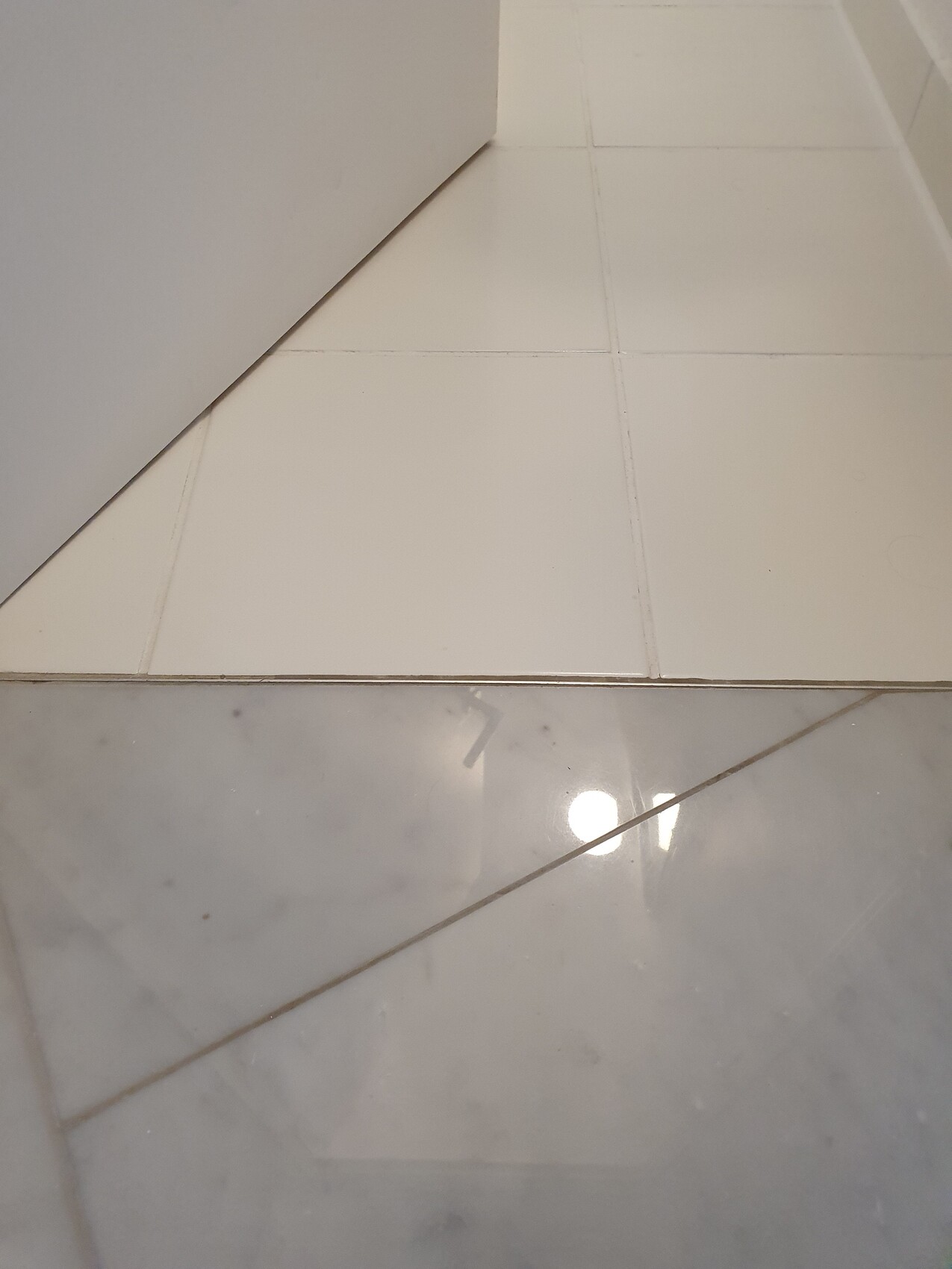

I haven’t removed the tiles yet because I wanted to think about if and how I will do it first. The transition currently looks like this:

Tommi27 schrieb:What do you mean by “unnecessary cuts”? Even with markings, there can still be a difference of a few millimeters. The transition is currently at one height, and I want to keep it that way.
I wouldn’t want to make unnecessary cuts there. For the height differences, you can mark the walls. Regards.
