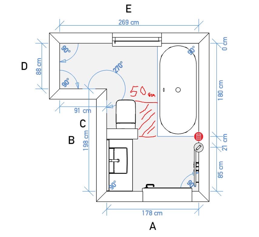

For the downstairs bathroom, we are considering:
a) Bathtub only (Option 2) or
b) Bathtub with shower option (Option 1).
General considerations:
Bathtub only:
In this case, the bathtub can extend beyond the window without any issues. Using the sloped ceiling shape, we maximize the width and ensure the tub doesn’t block the space. We plan to add extra storage space within the wall.
Bathtub with shower option:
I (dad) assume that with three women in the house there will eventually be disputes about who gets to shower when. Also, guests should have a shower option. That’s why I want to keep the option open to shower downstairs as well. I imagine choosing a regular bathtub and installing a folding splash guard near the window.
Yes, the bathtub is 75cm (30 inches) wide and extends beyond the window. Since a bathtub usually has a rim about 6cm (2.5 inches) wide, I’m thinking of attaching the splash guard not at the tub’s rim but where the tub slopes downwards (sorry, I don’t know the exact term).
As for the sink, I’m trying to keep it as shallow as possible or move it as far left as I can to avoid narrowing the walkway too much. Room width: 178cm (70 inches) / 50cm (20 inches) sink + 75cm (30 inches) bathtub = 125cm (49 inches) --> 50cm (20 inches) clearance at the narrowest point.
Alternatively, I could imagine using a curved vanity that gets narrower toward the right. My only concern is that the “curved” design might not quite fit the overall aesthetic if everything else is very linear.
For the design, we planned black tiles, wood-look surfaces, and white fittings.
Looking forward to your feedback!
Arnold

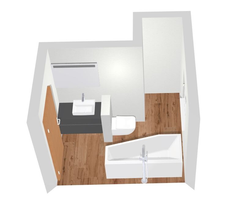

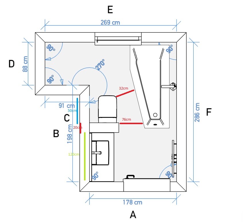

ArniBanarni
23 Dec 2020 11:59
I’m surprised by how quickly and how many replies I have received. Thank you!
The first idea to keep the shower and additionally install a bathtub isn’t a bad one. I have planned it like this for now.
Admittedly, this will probably only work with a classic bathtub that is max 70cm (28 inches) wide.
Since we have two small children and are planning for another, having a bathtub in the house is unavoidable. Even though we hardly ever bathe ourselves, I believe a bathtub should be available in the house.
I will share a plan for the upstairs bathroom later. The room dimensions are very similar. There we will have a 140cm (55 inches) open shower. When I take a shower, I usually get ready for work right after (even though currently it’s mostly just working from home ;-) ). That means: blow-drying hair, brushing teeth, etc. I would rather not keep all my toiletries in the ground floor bathroom, which is also used by visitors.
I also think having a bathtub could make selling the property easier.
I’m curious about your feedback. What do you think about a 50cm (20 inches) passageway? Do you see any other options? Placing the toilet under the window won’t work. We have a traditional window that starts quite low.

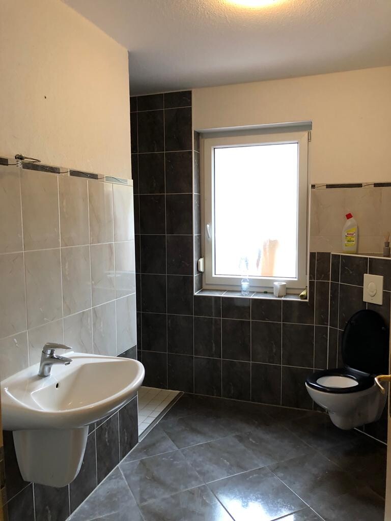

I have attached a photo of our current bathroom.

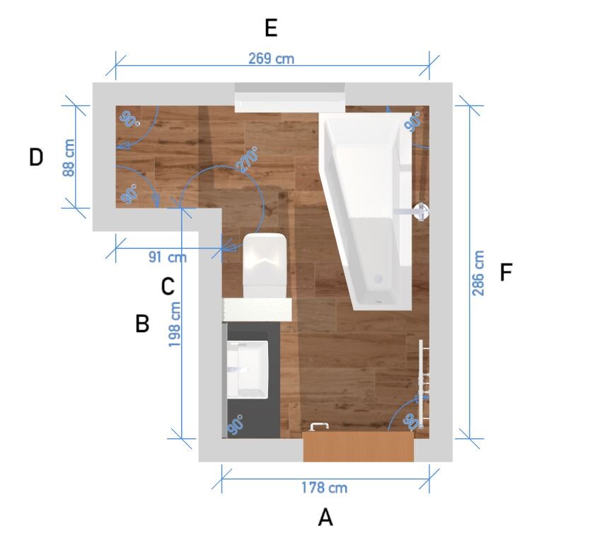

tomtom79 schrieb:
If the bathtub is placed under the window, then the toilet also has more space.
Why not put the toilet on the right side and place the bathtub entirely in the recess? Then there might also be room for a double sink.
Schimi179123 Dec 2020 12:43
The space for a double sink would probably be quite tight (although they are also available in 120cm (48 inches) width) 🙁
Something like this:
Floor plan of a bathroom: bathtub on the right, sink on the left; dimensions in cm.
Otherwise, I would place a built-in cabinet in the niche in the original design.
Schimi179123 Dec 2020 12:56
or like this:
Floor plan of a bathroom with bathtub on the right, storage space on the left, dimensions 269×180 cm (106×71 inches).
