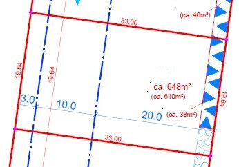

ᐅ Single-family house floor plan, approximately 150 sqm, with east-facing garden
Created on: 9 Jan 2020 21:17
O
OWLer
after reading many threads here about how well-intentioned floor plans are expertly dissected, I’m now stepping out from the shadows. We plan to build this year and have already purchased the plot. We are currently in discussions with two providers. Provider 1 never really impressed us with their designs and plans very large houses without offering much living space. I’m bringing Provider 2 into the discussion here because, apart from the points mentioned below, we still like their design.
We hope the collective forum expertise will point out some pitfalls and maybe even help solve our hallway dilemma.
Sorry for the rough sketches of the measurements.
Plot size: 610 sqm (648 with purchased noise barrier)
Slope: approx. 70cm (28 inches) over 19m (62 feet), sloping from north to south
Site coverage ratio: 0.4
Floor area ratio: 0.8
Building envelope, building line and boundary: 3m (10 feet) from the street, 3m (10 feet) to neighbors north/south, building envelope 10m (33 feet) east-west
Edge development
Number of parking spaces
Number of stories: 2
Roof type: gable roof ≤45°
Architectural style
Orientation: ridge running north-south
Maximum heights / limits: max. ridge height 10.5m (34 feet), eaves max. 6.0m (20 feet)
Other requirements: On the east side, a noise barrier is built along half of the plot, with forest behind it. Due to the noise barrier, the garden is practically not visible from outside.

I also don’t see any advantage to having a door from the pantry to the outside. The route isn’t any shorter than going through the front door.
Plan your kitchen together with the floor plan so you don’t regret it later.
A living room width of 3m (10 feet) is extremely narrow. It could work, but it depends on the furniture.
I understand that you want the office downstairs. But look at it this way: upstairs, you have one extra room, while the rooms downstairs could benefit from a bit more space.
Pinky0301 schrieb:
I also don’t see any advantage in having a door from the pantry to the outside. The route is not shorter than going through the front door. The irony is that going through the garden would actually be a shorter way from the kitchen to the pantry than inside the house.
There are a few aspects of the design that make me wonder whether they are the result of a long list of wishes or just happened by chance. Let me ask a few questions:
Do you really need two entrances?
Does the main entrance have to be at the front?
Does the staircase have to be straight?
Is west-facing sunlight in the living room important?
Is the L-shape of the main rooms (kitchen / living area) a must?
How wide is the lot?
Do you definitely want those narrow slit-style windows?
The pantry is great—I wouldn’t want to do without it! But ideally, it should be directly accessible from the kitchen or at least close by. It probably doesn’t need access to the garden. You don’t want it to turn into a shed, right?
The bedroom on the south side is not ideal if you don’t have air conditioning. On the other hand, the kids will appreciate bright rooms, since they spend time there during the day.
Hello everyone, thank you very much for the feedback. It’s exactly as hoped and feared! I’ll go through the posts chronologically.
First, a bit of background. We have been in contact for about six months, more or less closely, with a general contractor (GC) who currently builds around 20% of the houses in our development—without being tied to a developer! We’re roughly on round 10 and have never been completely satisfied. His initial drafts were always something like: “We’ll keep it simple. We’ll move this out from the foundation and make an extension for that room.” With every round, things somehow get more complicated and “deliberate.”
This is the first design from a GC who has a pretty good reputation here. If we signed now, construction would start in July, as everything before that is fully booked. When we picked it up and discussed it on site, we were quite enthusiastic. After a night’s sleep, however, we became a bit more thoughtful. Your comments certainly helped.
Our plot is 19.6m (64 feet) wide. The noise barrier on the east side, next to the forest, is because a heavily trafficked country road once ran at a 45° angle there, when the development was approved. Nowadays, it’s much quieter thanks to a new parallel road.
You are right about orienting the main rooms entirely towards the terrace. I had never looked at it that way. Here on the forum, everyone always tries to align everything south. But our best view and the quietest spot with the garden is definitely on the east side.
The big “Yes” for the kitchen island might have been misinterpreted by me. I actually want a narrow peninsula-like extension, not a full island. A proper island has never appealed to me. I’ll try to edit that in the original post later.
All our existing furniture fits, I’ve checked that.
I just noticed the 3m (10 ft) length of the bedroom. Previously, I only paid attention to the width. I think we need to revisit the “guest” situation. I had mentally reserved that room as a VR gaming room for Dad.
The carport is only for our van. The second car will be parked in the driveway or—hopefully in the future—replaced by a cargo bike. I commute by train anyway. As long as we don’t have children, this will still work. I currently can’t predict that. But I definitely don’t want a double carport.
I’ll look up that thread!
Nope, no chance! The brick cladding is absolutely non-negotiable!
Wow, that’s crazy! I hadn’t noticed that until now…
No, two entrances are not a must. The main entrance placement probably stems from wanting the bay window as a front feature. We started with the desire for a “captain’s house” style—only the bay window remains from that.
A straight staircase is a preference of the GC.
West sun in the living room is unimportant. Originally, I wanted the kitchen in the south-west. The idea was to have a view of the street or playing children while chopping and washing. But then the path from the kitchen to the terrace would have been very long. So now it’s in the north-east.
The L-shape of the main rooms was a wish to avoid having a direct view from the living area into the (messy) kitchen. We definitely don’t want the feeling of a “warehouse” with one long continuous room without visual breaks.
The plot is 19.6m (64 ft) wide.
Arrow-slit windows are not a preference, no.
OK, thanks for this really useful input! I’ve gone back and forth on the idea of access from the north via the carport. Especially since we are not allowed to build a small roof over the entrance outside the building envelope. North would be much better for weather protection if the front door is there. For me, this would mean the bay window needs to be meaningfully filled. I don’t see a WC there then; maybe swapping the office and WC?

How wide is the plot?

Attached is a screenshot of our plot from the subdivision plan of the building area. North is at the top. To the east, the forest is directly behind the noise barrier (blue triangles).
From the northeastern corner, it is 80m (260 feet) to the country road.
By the way, the road is only a private access road that loops around. Apart from residents and delivery drivers, hardly anyone drives through there.
