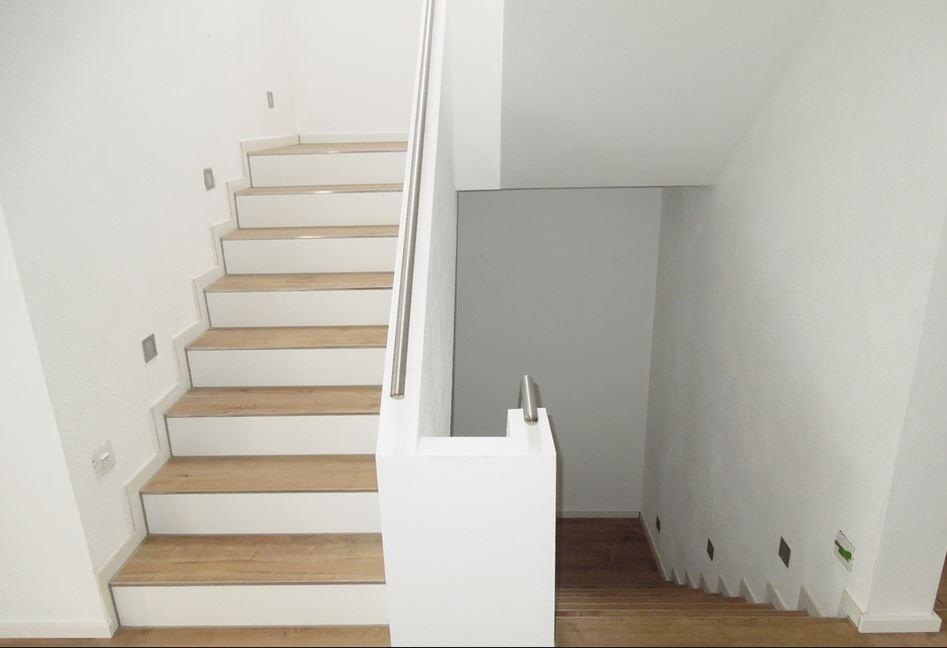

We have space for 2.4 m (7 ft 10 in) in width and 2.77 m (9 ft 1 in) in length on the upper floor, and 2.25 m (7 ft 5 in) on the ground floor, as I just drew in the plan. That should be enough, considering the basic dimensions of your staircase are actually smaller.
I still don’t quite understand why the staircase you showed is considered comfortable, while the one I designed is not. I would really appreciate any advice on what and how I could change it.

Have you ever considered a staircase with a landing?
The two intermediate steps between the landings might slightly interrupt the walking rhythm or feel a bit unusual at first when climbing the stairs.
We also considered building a staircase like this for a long time, but our house was too narrow for it.
Comfort is relative; true comfort only comes with an elevator, but the staircase should definitely be at least 1 meter (3.3 feet) wide. The minimum dimensions are just the minimum—they will work, but that’s about it.
@Bierbrauer84 You also have intermediate steps; do they feel “bumpy” for you as well?
With a landing, the height becomes too low, so we would rather choose the half-turn staircase. Also considering the 1m (3.3 ft) minimum dimension. So, probably a spiral staircase after all.
Are you also building with architects? I would simply discuss the matter calmly with them again.
A staircase doesn’t have to be uneven or rough; actually, any staircase that interrupts the natural walking rhythm can feel that way (ours does too). I once read that it’s generally best to ascend stairs without interruptions, such as landings, and that there tend to be fewer accidents this way.
However, we preferred something more visually appealing and accepted this trade-off. Larger and wider is always nicer, of course, but there are limits. As I said, the staircase will definitely work, and I can also quite nicely imagine how it will look.
