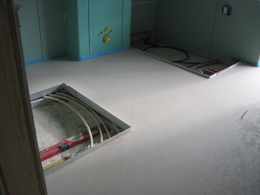

Irgendwoabaier8 Feb 2016 18:52Similar in our case – but the bottom layer is a heavier gravel fill.
First, the installations (electricity, water, ventilation),
then the fill
then a membrane,
on top of that underfloor heating,
and then anhydrite screed.
then waterproofing again, tiles on top,
elsewhere parquet flooring on top,
and the whole construction is not any thinner than a concrete slab.
