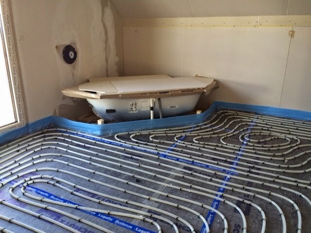

Hello Martina,
yes, definitely.
This is how our bathroom floor (top floor) looked before the screed was poured:
Shell bathroom with underfloor heating pipes laid and bathtub on the back wall.
On top of that, a standard screed layer was applied.

Doc.Schnaggls
8 Feb 2016 17:23
Our ceiling has a total thickness of 46 cm (18 inches) – 30 cm (12 inches) wooden beam ceiling plus 16 cm (6 inches) screed. On top of that comes the floor covering.
I can look up the exact structure for you tomorrow – at the moment I’m on the go and don’t have my construction specification with me...
This ceiling assembly is standard with our house manufacturer – we didn’t choose anything special.
