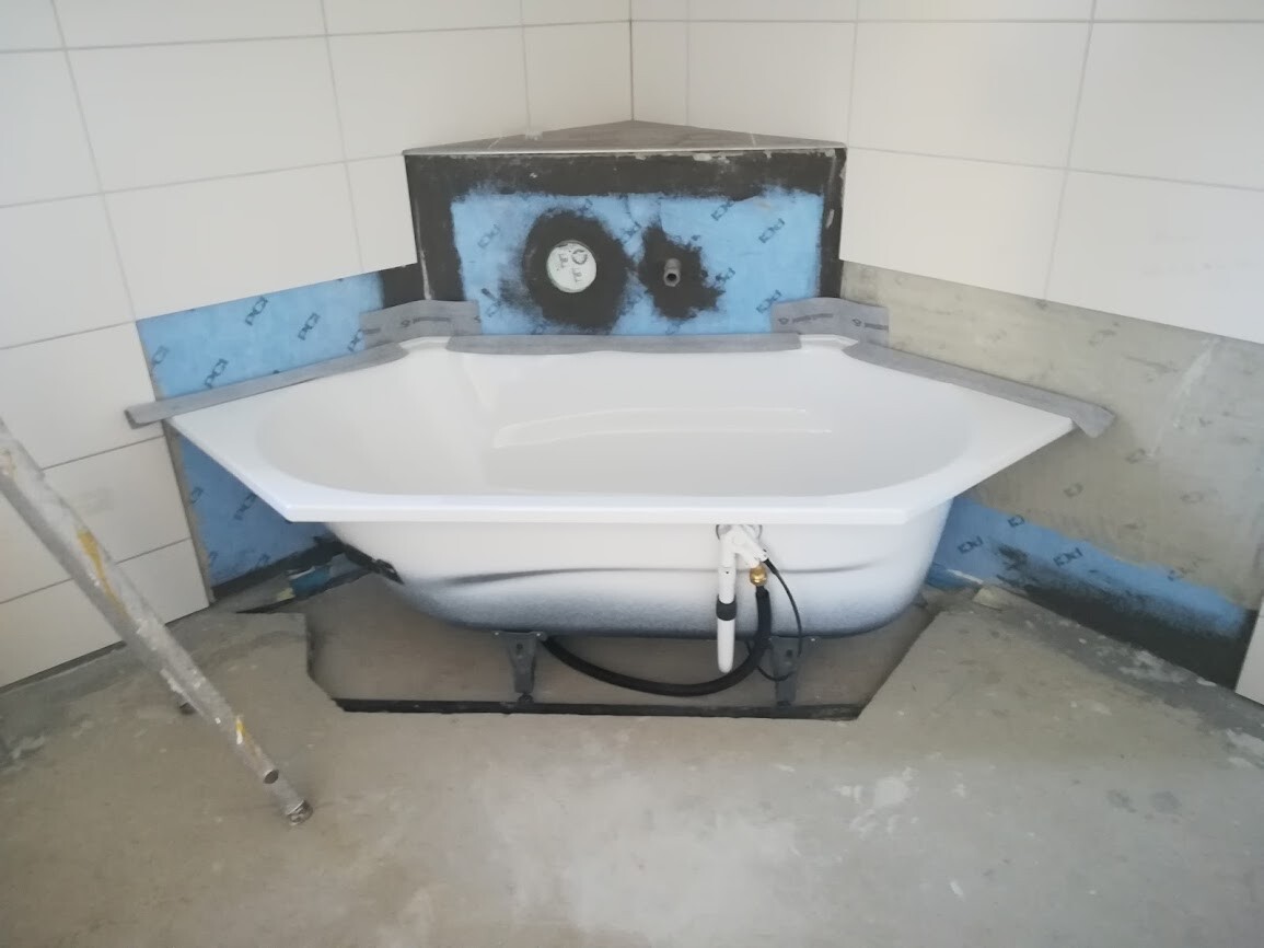

We are currently building a new house, and the plumber has installed the bathtub using a bathtub sealing tape. Now there is a disagreement between the tiler and the plumber about who is responsible for connecting and sealing the tape to the wall. The issue is less about the work itself and more about the warranty.
Eingebettete Badewanne im Bau, sichtbare Rohre, blaue Isolierung an Wänden.

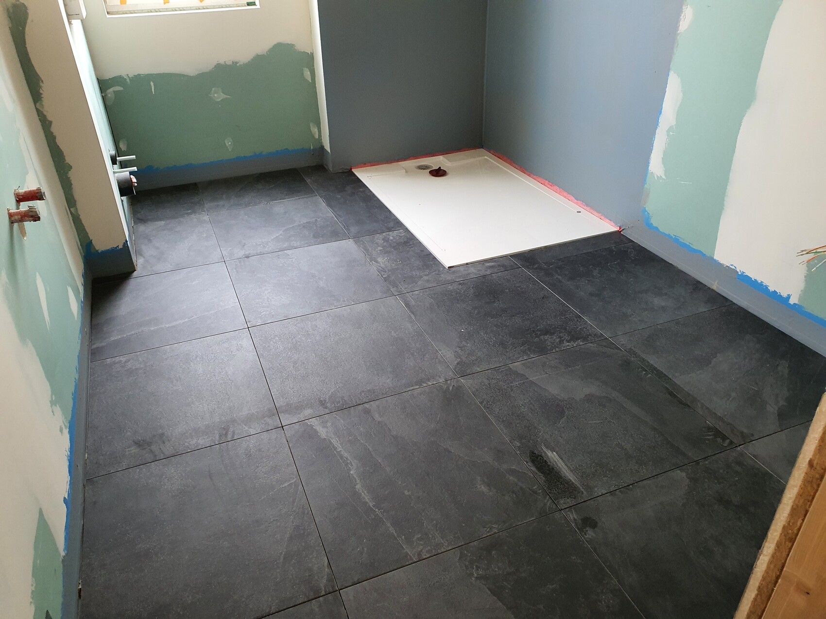

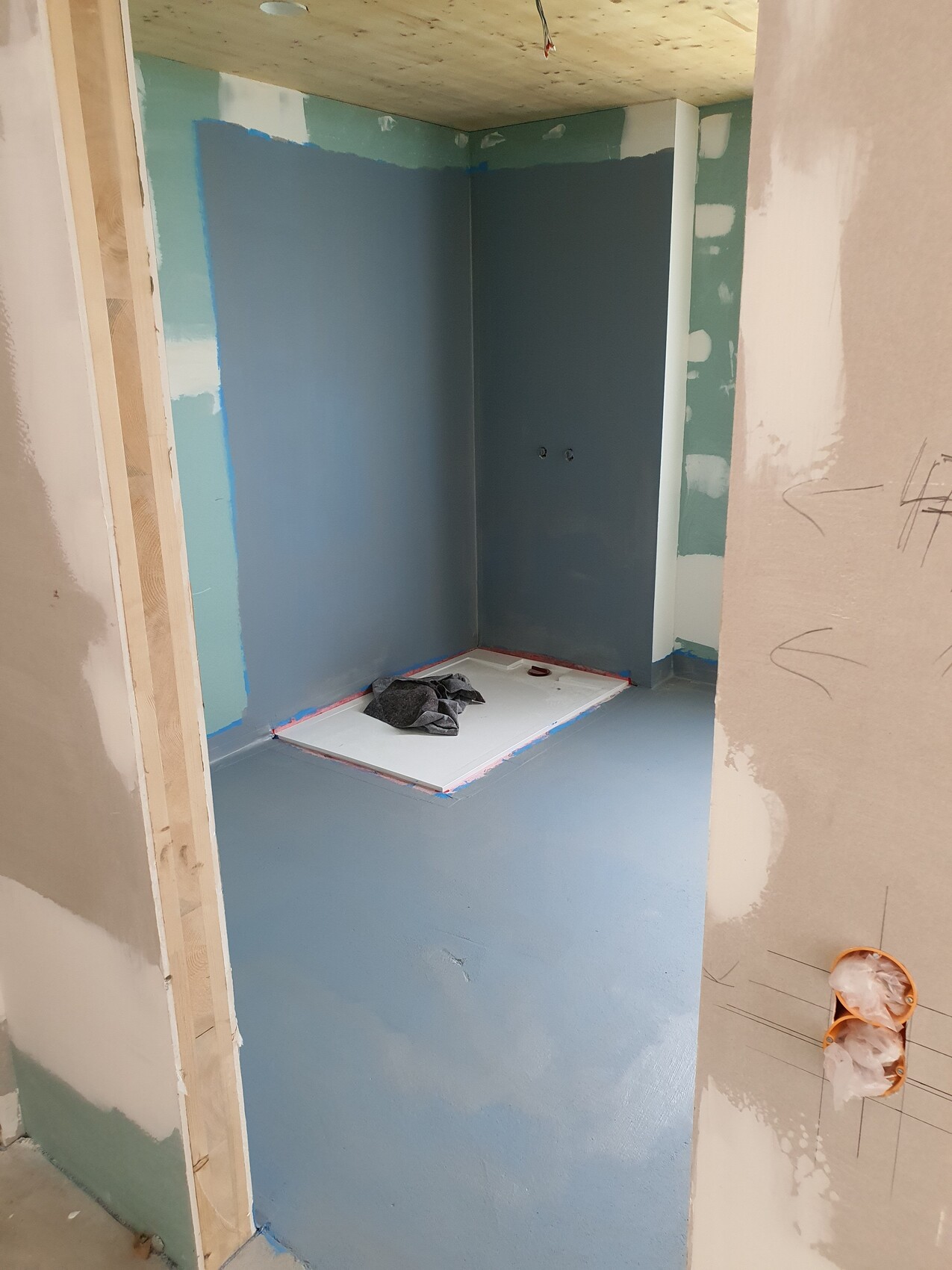

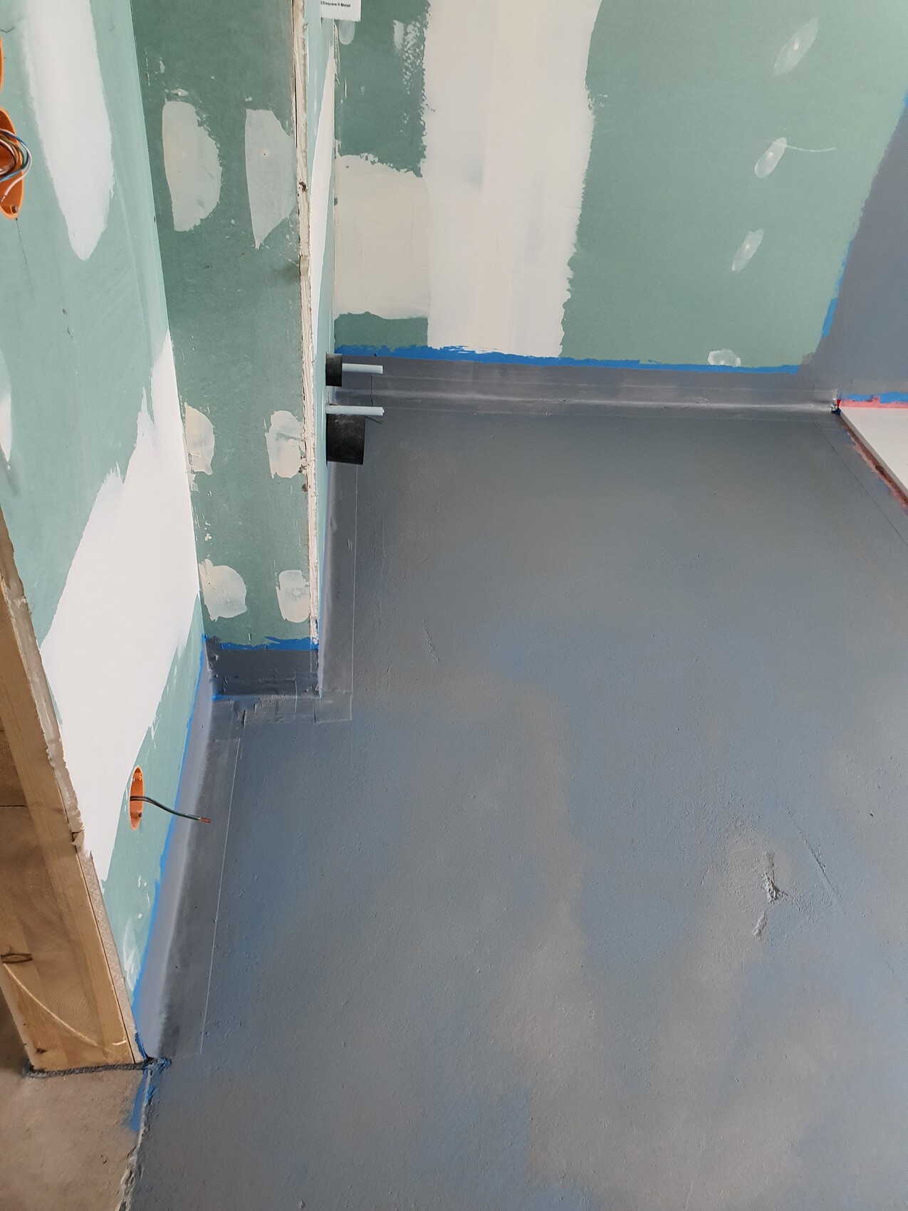

i_b_n_a_n6 Jan 2022 09:19
Bathroom construction site: blue waterproof coating on walls, shower tray with red border.
Renovation room with gray floor, green painted walls, and blue painter’s tape.
And like this with tiles:
Bathroom under renovation with dark floor tiles, white shower tray, and unfinished green-blue walls.
This is what a bathroom looked like after the second coat of paint. And who else but the tiler is supposed to do that? (By the way, this is not exactly my bathroom shown here; we have 4 bathrooms in the house for 4 separate residential units.)
