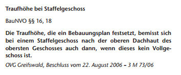

The eaves height, which is set in a development plan / zoning plan, is measured at the upper roof surface of the top floor in a stepped (setback) story. Even if it’s not a full storey.

A mansard roof might be an option—or, as a building expert calls it, a recessed upper floor—although this likely depends somewhat on the federal state where the ridge height is measured.
For example, I found a ruling from Greifswald regarding this:
