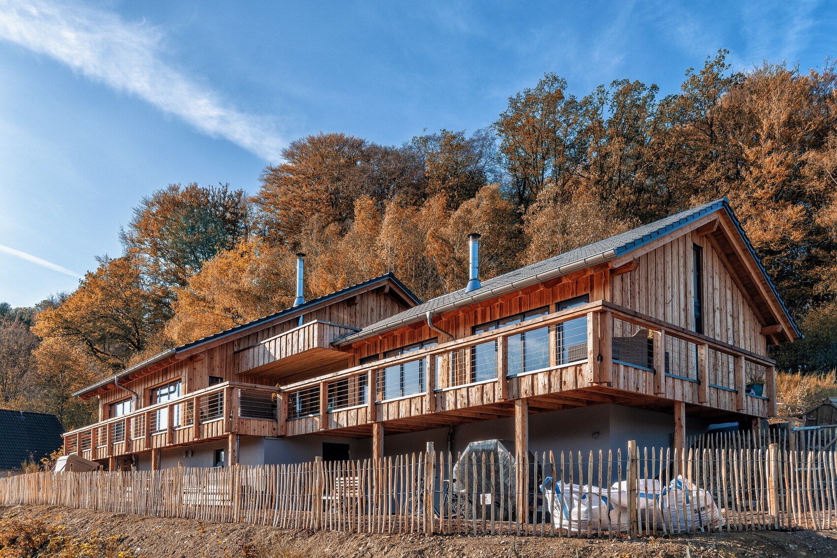

Here is my planning thread
https://www.hausbau-forum.de/threads/haus-mit-dachterrasse-in-passau.13943/
Pictures of the interior can be found here
https://www.hausbau-forum.de/threads/haus-bilderthread-zeigt-her-eure-hausbilder.14011/post-235632
https://www.hausbau-forum.de/threads/haus-bilderthread-zeigt-her-eure-hausbilder.14011/post-237153
Exterior photos here
https://www.hausbau-forum.de/threads/haus-bilderthread-zeigt-her-eure-hausbilder.14011/post-257355

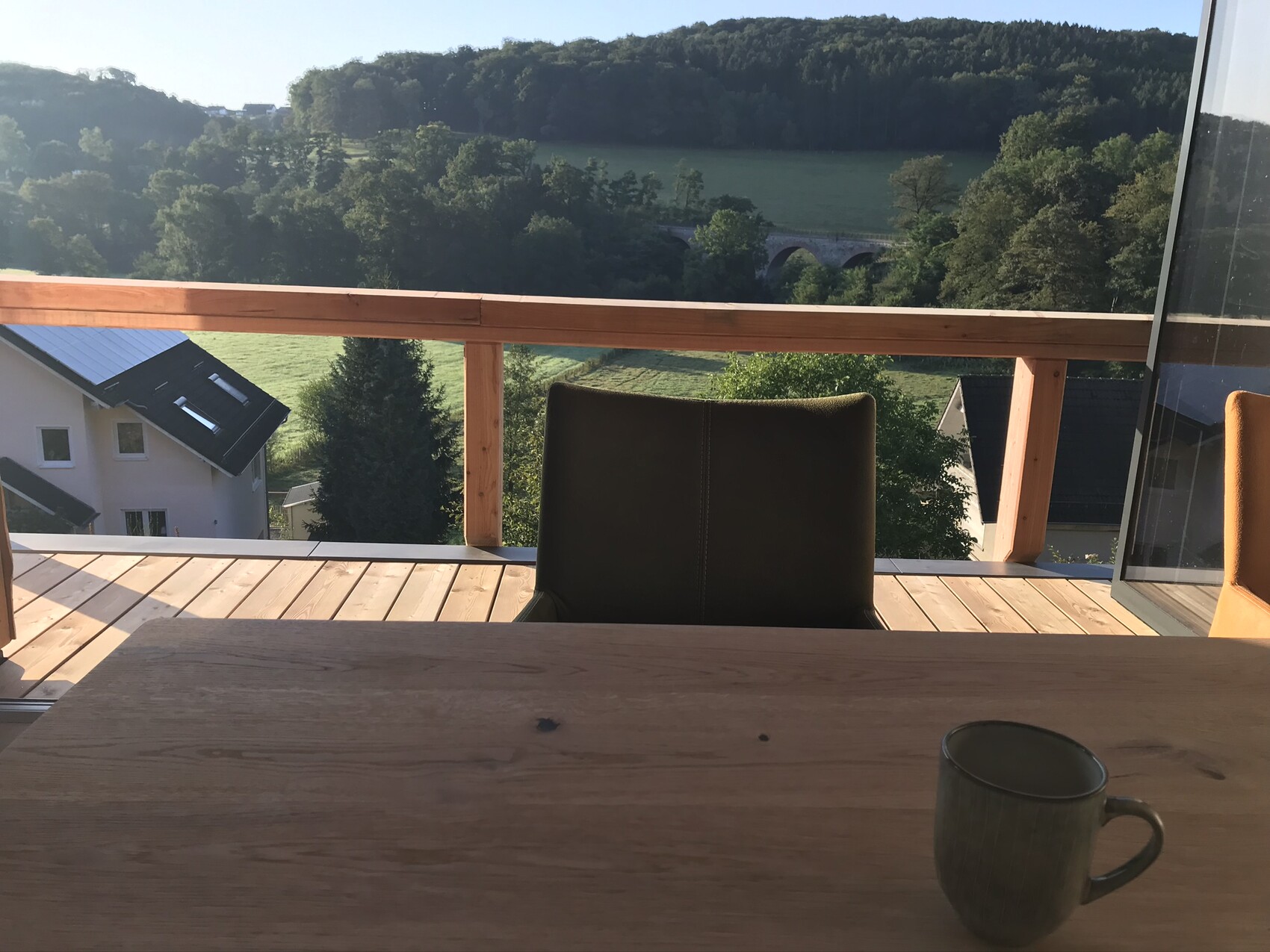

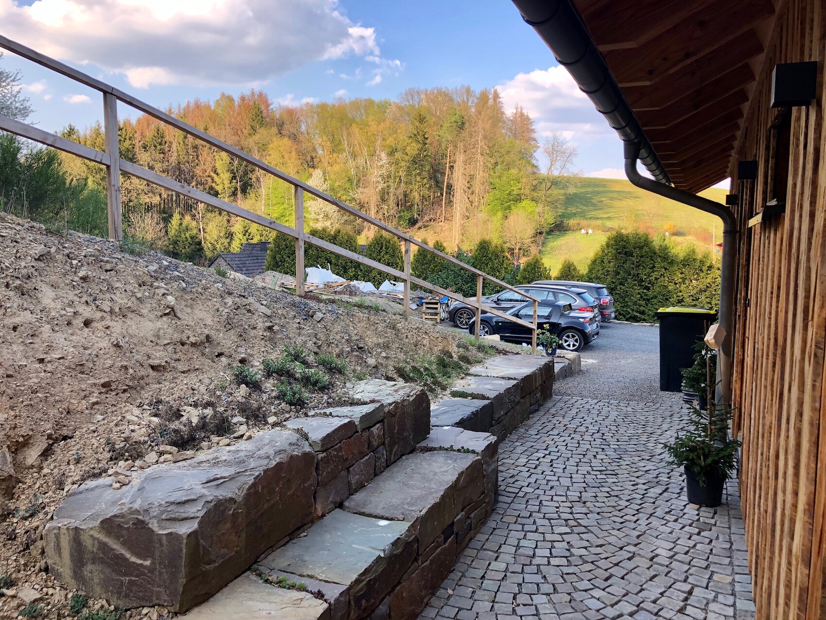

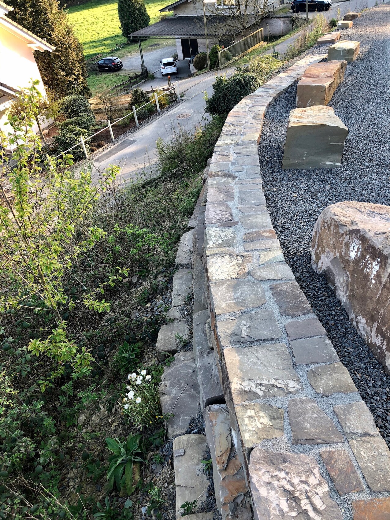

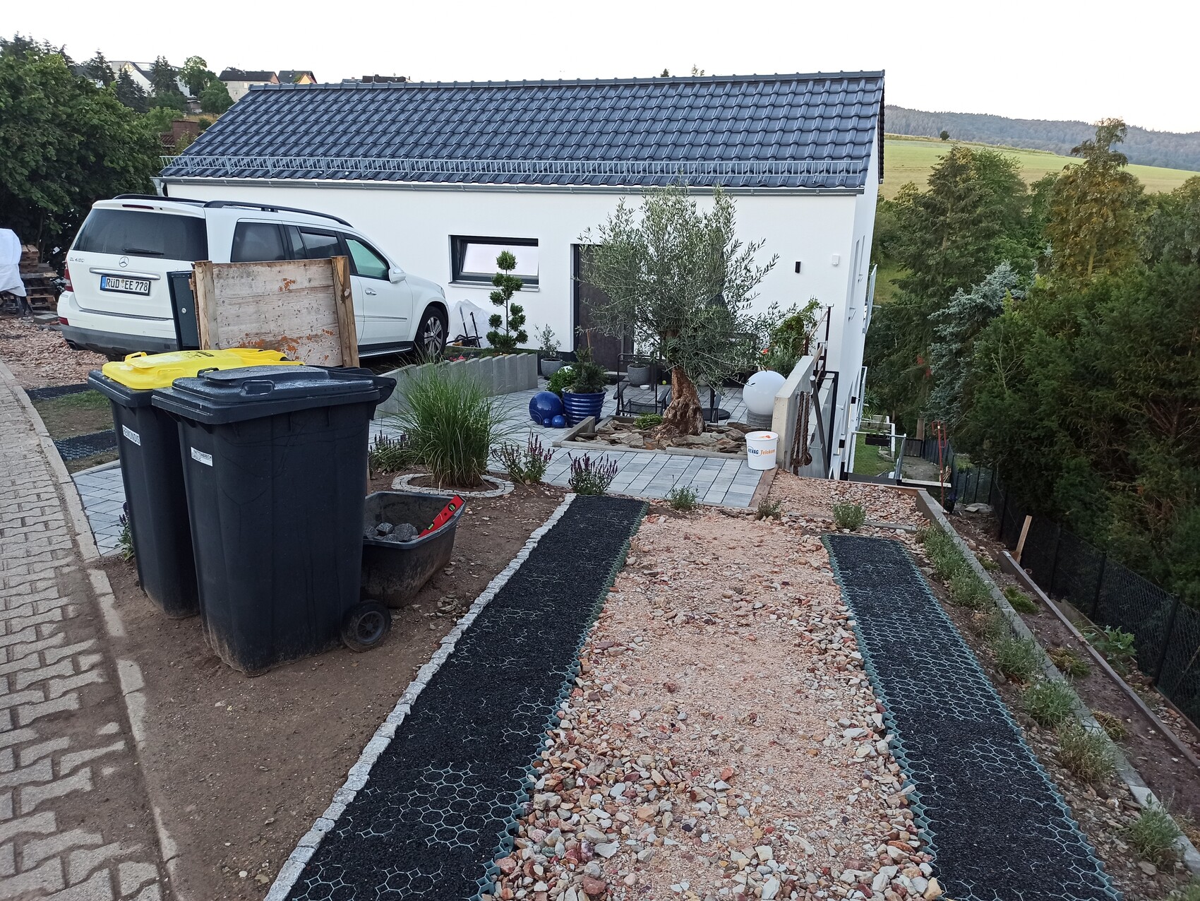

hampshire24 Sep 2020 22:55I can’t find the thread anymore.
I once posted a floor plan somewhere. We built a single-story house quite high up on a hillside. One side is built into the slope, supported with concrete foundations, and the other side extends slightly out of the hill. The slope is a bit steeper than yours. We have a somewhat larger plot than you and were therefore able to build a bit wider, but with hardly any depth. The left half of the house consists of one room plus a bathroom over two levels. Under the upper level on the north side, there is rock. In the middle is a combined space for the entrance, laundry room, and wardrobe. We made separate apartments for the children next to us. Their own front door, kitchen unit, bathroom, and no connection inside the house. To the south, the living units are connected by a wooden terrace/balcony. It wasn’t exactly cost-optimized, but after a little more than a year living in the house, we feel very comfortable. The hillside and driveway added significant extra costs. In return, we have a wonderful, unobstructed view over all the roofs of the 40-house village down into the valley.
Details gladly via private message or feel free to visit.
The pictures are not very recent; some areas are now more overgrown again, the rubbish cleared away, and the hot tub set up.
House with a south-southeast-facing balcony
View with coffee from the dining table:
Slope reinforcement at the driveway:
Entrance on the north side:

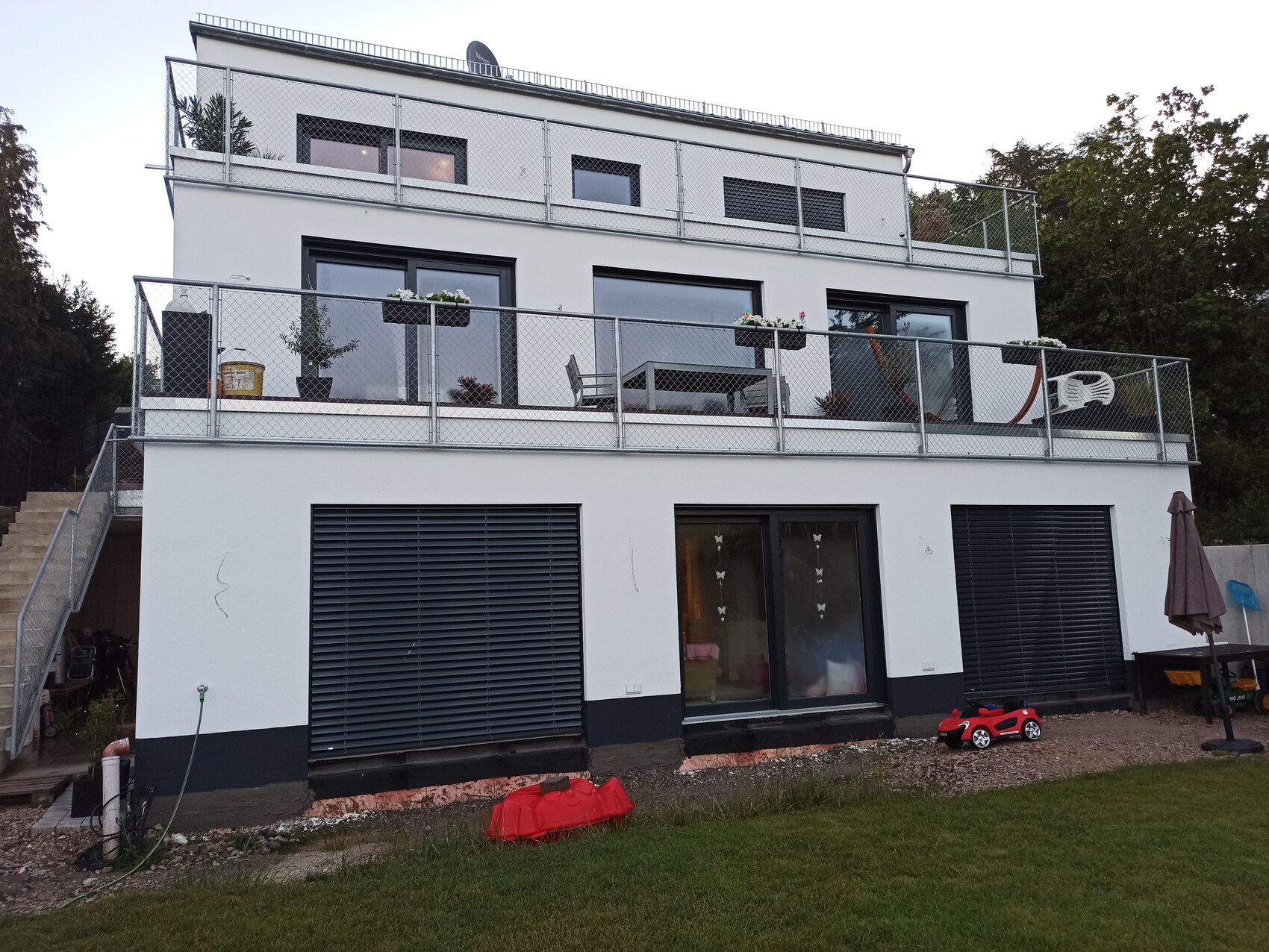

sichtbeton8225 Sep 2020 13:23I can only advise you to work with an architect who is already well known and trusted by the local building authority and discuss your project with them. We went to our initial consultation with a very simple sketch. We planned three floors. The lower floor extends further out compared to the upper floor (terrace/balcony). We also have a very old development plan that requires building only one full story. That means one full floor. The attic is not considered a full story because it is smaller than three-quarters of the ground floor. The basement is not a full story either, as it is (on average) below ground level.
From above, very minimalist...
Regarding eaves height, in our case, even the building authority could not provide a 100% clear definition. They could not give us a fixed reference point because the definitions varied. Basically, however, the authority did not mind as long as the building fit in with the neighboring structures. It is also important to know, for example, if anyone on the street has violated any regulations (dormers, building setback, roof tile color, unauthorized brick cladding) or if other circumstances suggest a deviation from the standard. Locals in our area knew that parts of the street had been raised by about 1.5m (5 feet). As a result, the issue of eaves height became irrelevant because we argued that it had to align with the street height increase.
As I said, take the opportunity to talk to the building authority...
