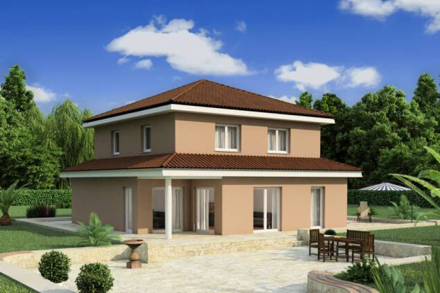

Milanni123 schrieb:He could have suggested a stepped story design. There’s a lot of flexibility there, and if cleverly designed, the house can truly look Mediterranean (for example, see the attached development).

Milanni12319 Nov 2015 10:54Bauexperte schrieb:
Mediterranean style and single-story is a contradiction. You probably mean a two-story townhouse? No, I actually mean like in your attachment, so a stepped floor. I'm not very familiar with the specific terms.
Bauexperte schrieb:
Not mostly; just at the triangle where the floor meets the rising masonry; unless the captain’s gable is placed over a dormer. The captain’s gable is indeed supposed to be placed over a dormer.
Bauexperte schrieb:
He could have suggested the stepped floor to you. There’s a lot of flexibility there; if designed cleverly, the house really looks Mediterranean (see example in attachment). Yes, he said that for a stepped floor he needs a minimum ceiling height of 5.25m (17 ft 3 in).

Bauexperte19 Nov 2015 11:11Milanni123 schrieb:
Yes, he said that for a recessed top floor he needs a minimum ceiling height of 5.25m (17.2 feet) Then he should hit the books again
