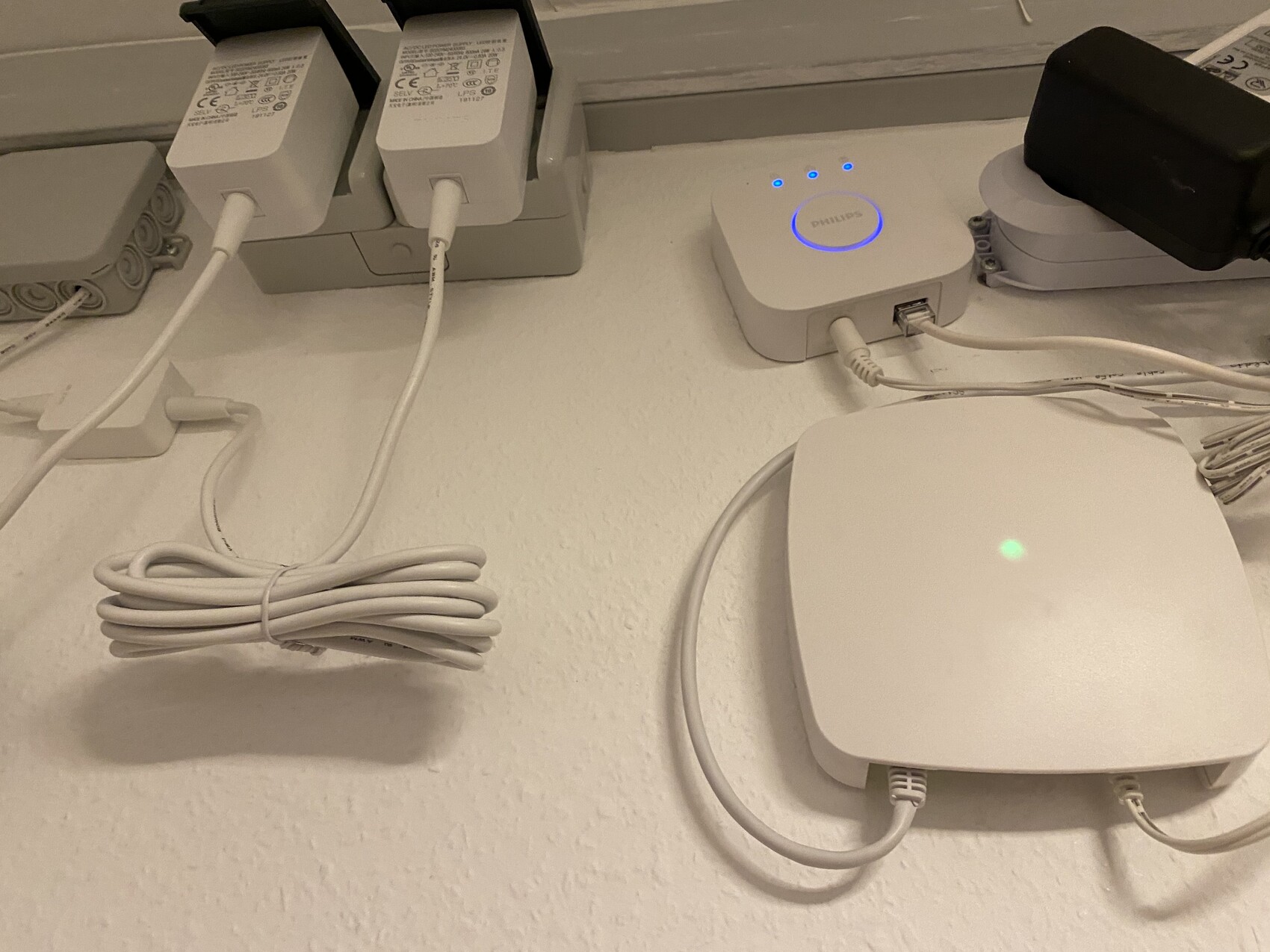

KNX is way too expensive and overrated. Rademacher Homepilot controls roller shutters, door sensors, smoke detectors (which close the shutters in emergency) very cheaply, as well as Hue lights and heating. Everything works perfectly.And no power outlet... only with some kind of plug-in adapter. Thanks, but no thanks.Roookie schrieb:

And no socket outlet... only with some kind of intermediate adapter. No thanks.
IT is not electrical work, so I’m a beginner in this field. The name says it all 😀What kind of intermediate adapter???sysrun80 schrieb:
