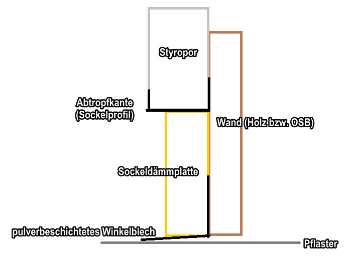

The shed does not rest directly on the ground but has about 2cm (¾ inch) of air gap to the paving. I installed a sheet metal piece bent at a 120° angle there:
And at the end, I applied a professional plaster finish, including reinforcement mesh, base coat, then regular plaster on the upper part and base plaster on the lower section.
