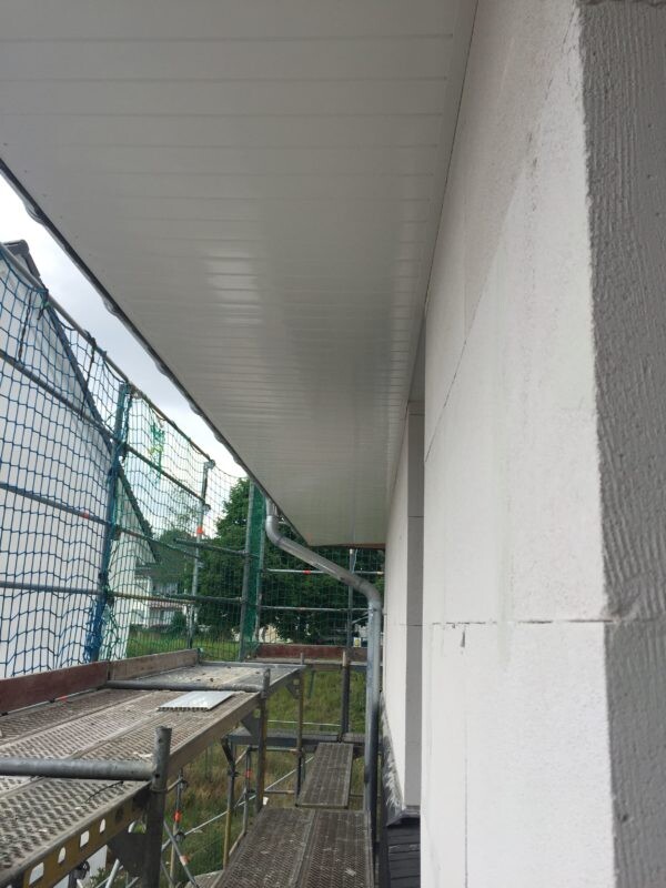

We visited Gertudisvilla in Euskirchen. Just search for it online.
Here is a photo related to this.
Exterior view of a building with scaffolding, a walkable metal platform, and a downspout on the facade.
Unfortunately, I can’t send a private message to @Golfi90 yet because we don’t have enough posts. He might be able to help us with how Schmiedhaus built their structure. Their facade looks like the one we want.
