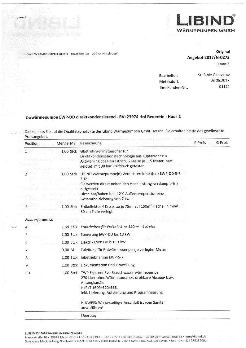

The first company works with refrigerant, and the second with water.I don’t quite understand that yet. Both offers provide direct expansion heat pumps with ground collectors. How does one of them use water? Or are you referring to Beglau’s offer, since it mentions condensation in the storage tank? How does the underfloor heating get warm then?
I have to admit I haven’t dealt much with direct expansion heat pumps so far.
In terms of content, both offers are definitely hard to compare because they provide very different services, but I assume you are aware of that. Beglau doesn’t mention the length of the required ground collectors at all (but apparently criticizes the competitor’s length, if I understood your last post correctly) and doesn’t offer installation at all.

I just checked the Libind and Beglau websites.
Libind
The refrigerant flows through the collectors and also through the underfloor heating. What I haven’t found out yet is whether these are two separate circuits or just one circuit.
The domestic hot water is apparently produced using a separate domestic water pump.

Libind

Hausbau8314 Jun 2017 20:36I also think the water storage is set a bit too high. We have 130m2 (1400 sq ft), so I believe 150m2 (1615 sq ft) should be sufficient.
We know about the garden; we only want grass there since it is located at the back of the property.
I was mainly concerned about which of the offers seems better.
