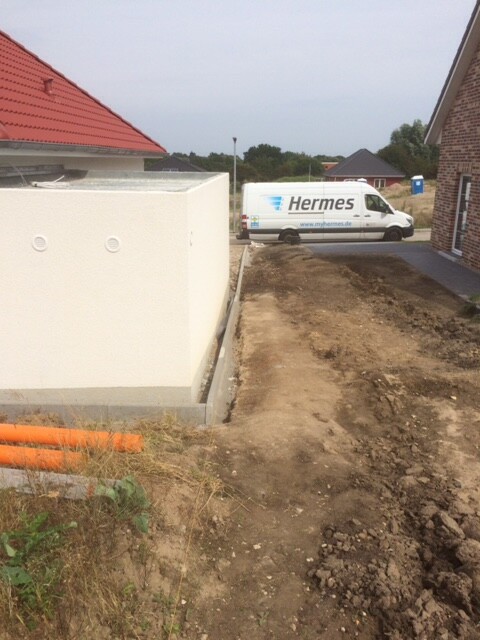

Nordlys
18 Aug 2017 14:25
Construction site with white unfinished wall, earthworks, and Hermes delivery van at the house
This is how we handle the entire house. Gravel stones are placed in the gap between the wall and the curb. The curb is set in concrete. On the building wall, there is a membrane and waterproof slurry. Beneath the gravel is backfill sand. For the terrace, there is also a drainage system underneath. In front of the house, it is unnecessary because the ground slopes downward from the wall toward the street.
The lawn issue is caused by the concrete and the sand. It will resolve over time as the soil around the curb recovers. Karsten
