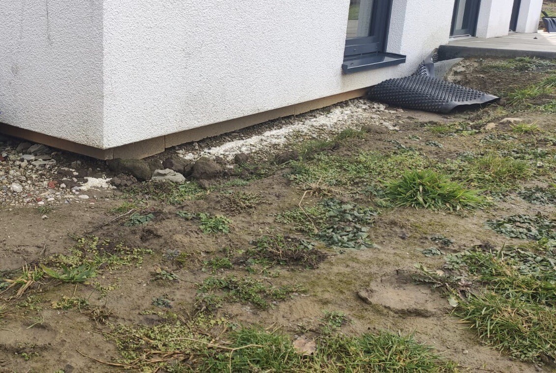

we have been searching for a house for quite some time and have finally found a great one.
The interior of the house is fully finished and complete. Only the exterior still requires some work. To properly estimate the costs, we are currently preparing a (financial) plan for the exterior design.
While doing this, we realized that we are not sure whether the house just needs a splash guard or if the foundation has only been partially done and still requires insulation and other work.
Since we are complete beginners, we would appreciate your advice.
Sabine
White plastered exterior wall, visible foundation wood below, gravelly ground with stones
Exterior area of a house: foundation covered with plaster, gravel ground, weeds, and black drainage mat.
Exterior wall of a building with soil next to the foundation and visible drainage mat.

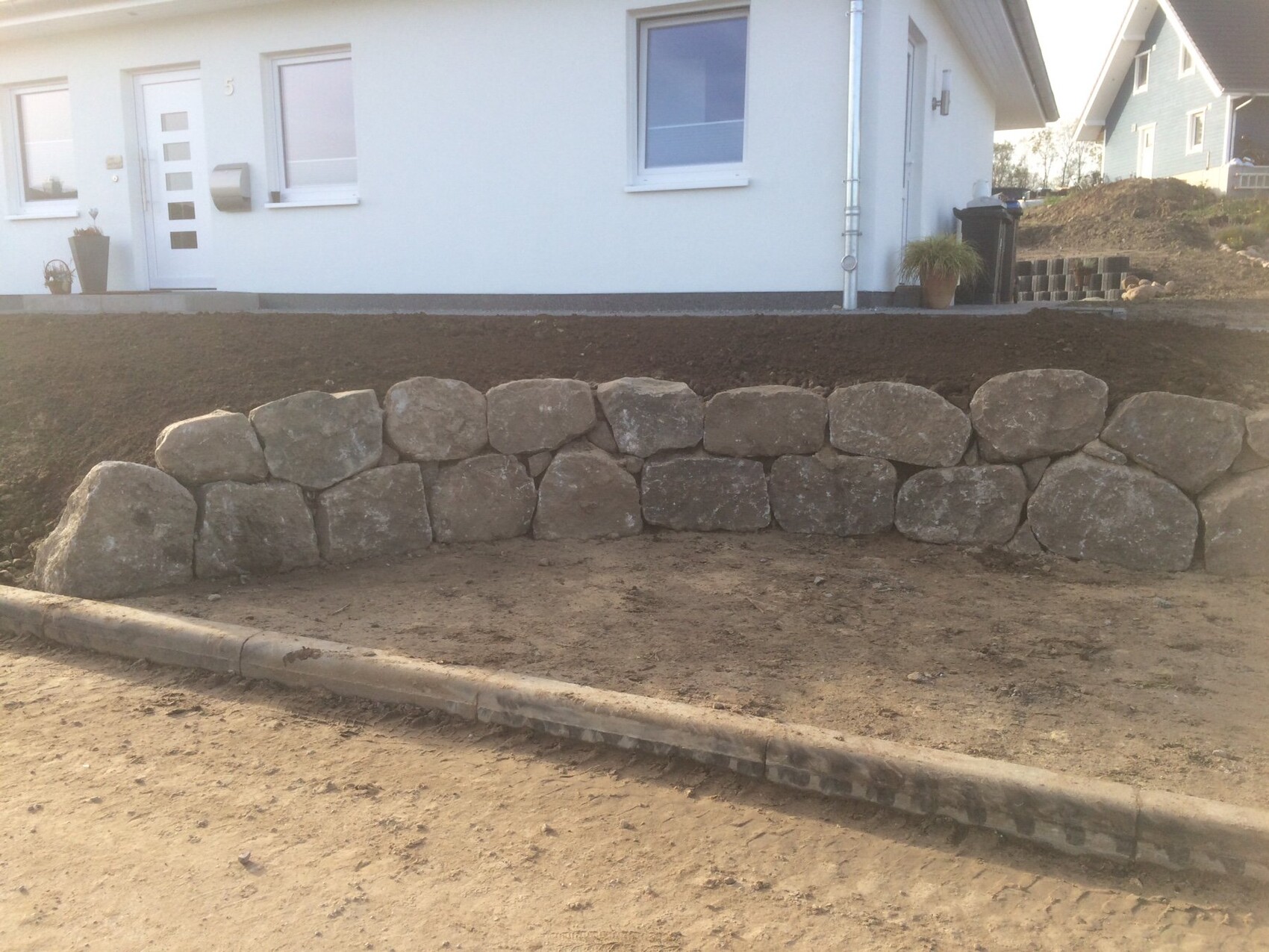

Nordlys
30 Jan 2021 20:52
The base coat plaster is missing.
Large natural stone retaining wall in front of a white single-family house, with soil and curb in front.

Is the brown material the insulation of the concrete slab?
How large are the roof overhangs?
The dimpled membrane should at least be installed correctly.

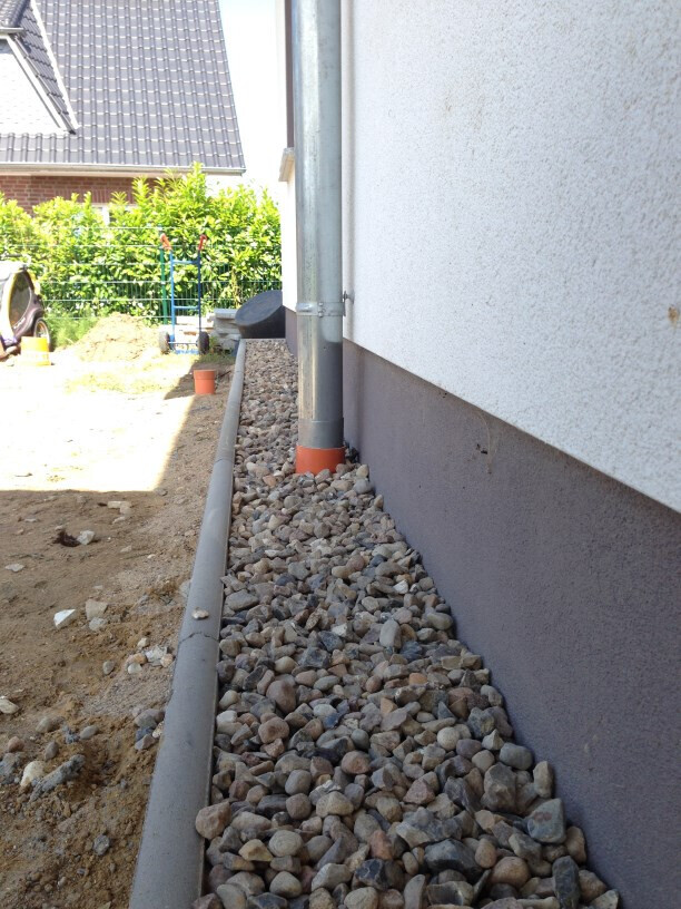

31 Jan 2021 10:33
It should actually look like this in the end.
Exterior wall of a house with downpipe; gravel bed at the foundation, construction work in the garden.
softeran
31 Jan 2021 15:18

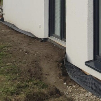

Yes, the brown material should be the insulation. There is no basement. I’m not sure if this information changes anything.
The roof overhangs are 63 cm (25 inches) on each side.
The dimpled membrane was apparently installed only in areas where something was already built onto the house – the terrace and the kitchen exit.
We are planning a splash guard around the entire house using dimpled membrane, geotextile fabric, and gravel.
We are just not sure if anything else needs to be done here.
Nordlys
31 Jan 2021 16:36
Yes. Base plaster, with a moisture barrier behind it, for example, a waterproof slurry. Some prefer bitumen paint, but it is toxic during application. Be careful and wear a full protective suit. You can mix and apply waterproof slurry yourself. Just search online. There are some YouTube videos. Base plaster is something for professionals.
