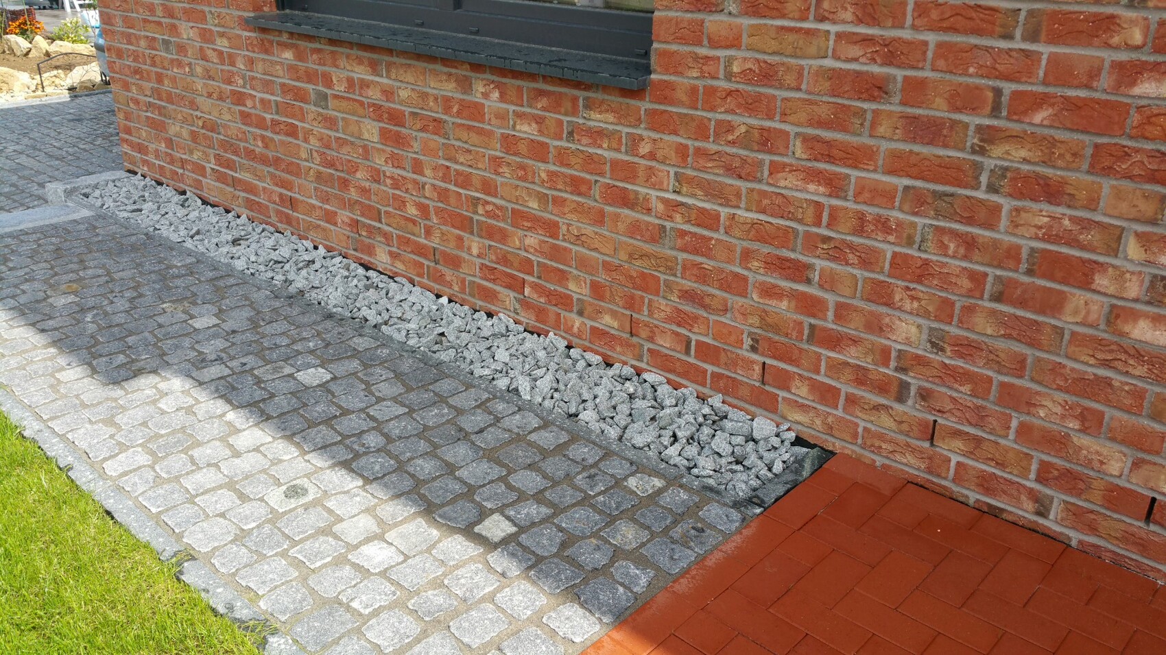

Here is our version with granite. Taken shortly after the rain. Moss should be cleanable with a pressure washer if the stones are large enough. I just noticed that the gravel has settled a bit. I’ll need to top it up again.
Exterior view of a red brick building with a gravel strip at the foundation and a paved walkway.
Wow, that’s quite a lot of paving stones, especially with the driveway further back. How much did you pay for paths and similar work?
