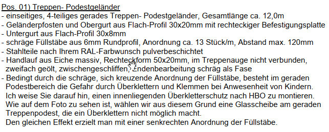

@11ant: How do you know what the original poster commissioned?
When I ordered my railing, there was never any discussion about the type and finish of the welds. We only know that he apparently did not order that option – whether it was offered to him, we do not know (but this likely would not be a legally actionable "omission," more a matter of customer service that could be improved).
