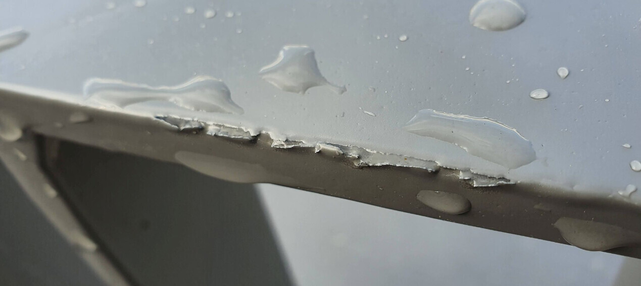

There are also paint damages that are so obvious that, in my opinion, any reputable tradesperson should have fixed them before final acceptance.
Close-up of a gray metal edge with water droplets and chipped paint.

Take a close look to the left and right where it all begins...
Additionally, the lower and upper "frays" fit exactly into each other.
I’m sure it feels sharp-edged when you run your hand over it.

Exactly. I have enlarged it for the skeptics:
Gray painted metal surface with chipped edge and water droplets.

I don’t know where you’re seeing paint chips here?!
In the second picture, I see a torn edge! That can’t be repaired.
As a layperson with no knowledge of the manufacturing steps required for such a railing, could you explain what would be necessary to get a proper railing? Also, what problems should I expect if someone tries to touch it up with a paint pen? Will only the appearance suffer, or will the durability against weather damage also be affected?
From your explanation, it sounds like the damage didn’t occur during installation but was already there before the powder coating was applied.
Alessandro
23 Jul 2020 16:02
In my opinion, there’s no way to fix that anymore. Especially not with a touch-up pen. The photo alone should be enough to claim it as a defect with the manufacturer. They should be able to identify it just from the picture.
From my layman’s perspective, the damage shouldn’t affect the durability. It just looks ugly and could cause injuries.
I would insist that the element be replaced.
You can see from the dent on the far right that this damage must have occurred before the powder coating.

By the way, you already have deep scratches in the coating on the handrail!

As a layperson with no knowledge of the steps required to manufacture such a railing, could you explain what is needed to get a proper railing?
Maybe you should carefully read through the thread; everything has been explained (several times).
Typ12345 schrieb:
To me, your explanation also sounds like the damage did not occur during installation, but already before the powder coating was applied.
Definitely yes. You failed to have the weld seam cleaned up by grinding and polishing, and thereby allowed welding spatter that stuck to the material to be coated as well.
Typ12345 schrieb:
Or which problems should I expect if he tries to touch it up with a paint pen? Will only the appearance suffer, or also the durability against weather damage?
You can’t fix this by simply adding extra paint!
I don’t understand you: you are the original poster and don’t have to misinterpret photos like other participants. You can get close to the actual object and tell the difference between material adhesion and an apparent scratch. This is actually the opposite and can at least be identified by touch if you confuse it visually. The material’s durability is compromised because the areas with welding spatter were not galvanized before coating. More than just an optical “touch-up” is not really possible now: I would carefully grind off the welding spatter burrs, and as an additional treatment, a paint pen would be acceptable. You won’t fix the entire cheap workaround damage now—except by a totally disproportionate and pointless full replacement (which would be your responsibility and no one else’s). The welder did a proper job (as the saying goes, you don’t get what you haven’t paid for), and the coating provider (not exactly friendly, but correctly) coated what was delivered to them. Typical cost-cutting consequences; next time you can be smarter.

Actually, the photo should be enough to report this as a defect to the manufacturer. They should be able to recognize that from the photo alone.
It’s easier to misinterpret in a photo, but the expert on site will not be fooled by that.
