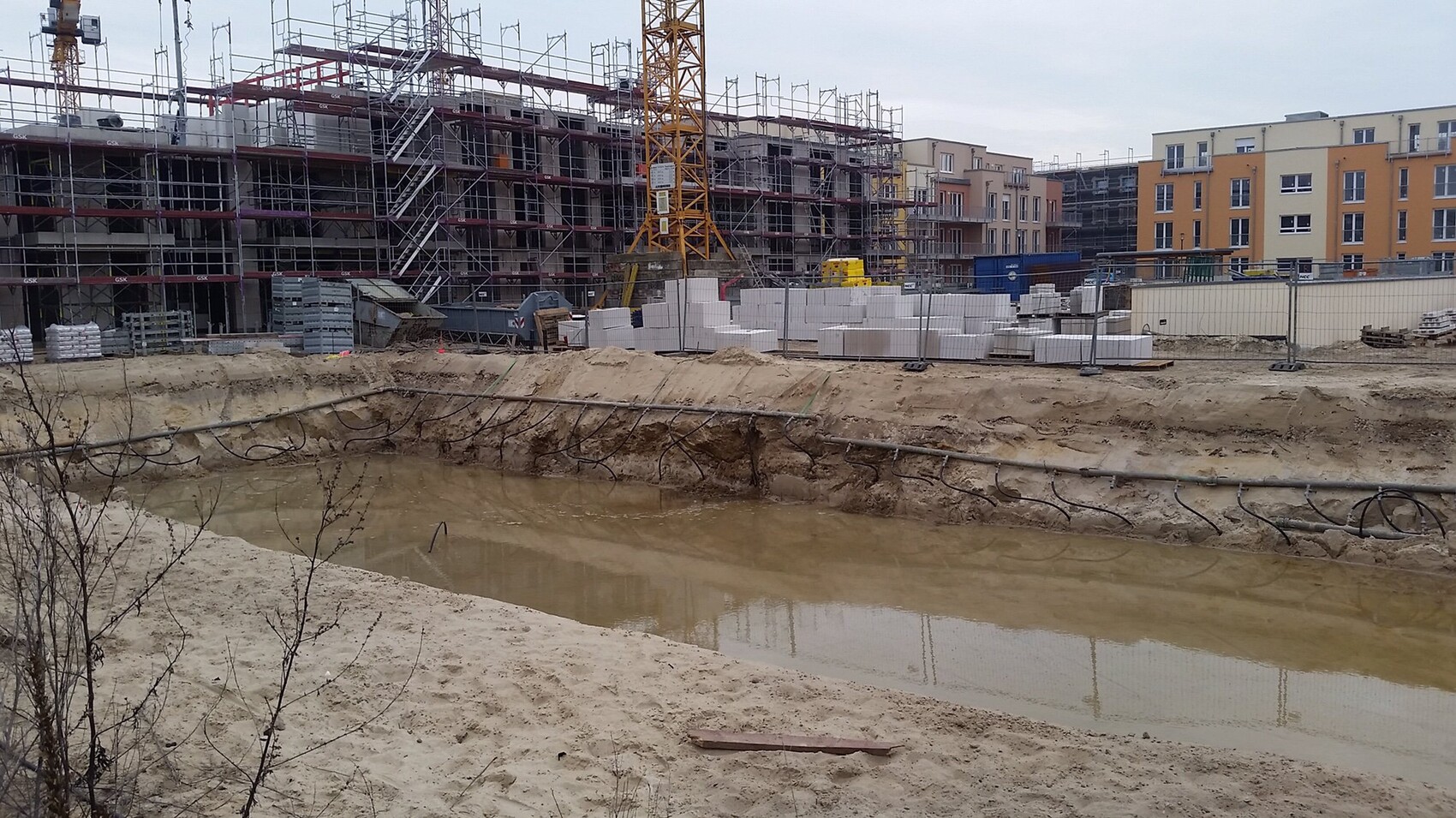

Steffen8018 Aug 2017 08:16Our shell construction flooded several times during the winter. At times, the water level was as high as 2cm (0.8 inches). However, this is not a problem and just needs to dry out again.
HilfeHilfe18 Aug 2017 08:43Steffen80 schrieb:
Our shell construction flooded several times during winter. The water was sometimes as high as 2cm (0.8 inches)… but it’s not a problem. It just needs to dry out again.And is your villa still standing? ^^
Steffen80 schrieb:
Our shell structure flooded several times during winter. The water stood about 2 cm (1 inch) high in some places, but it’s not a problem. It just needs to dry out again. We had about 50 cm (20 inches) of water standing in the basement (tank waterproofing); we had to pump it out for a long time.
