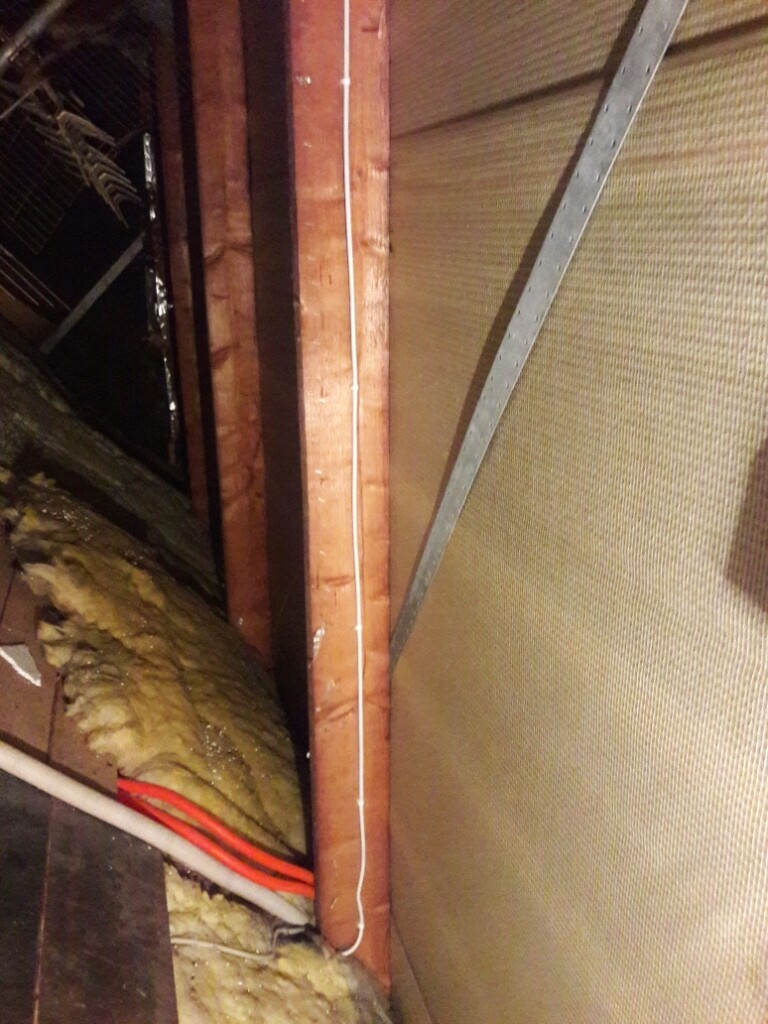

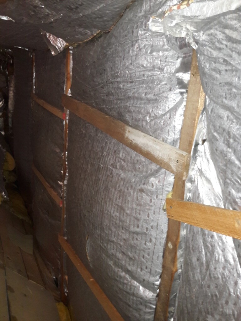

I would like to completely seal my roof from the inside. The most important goal for me is to make it more airtight because right now, there are drafts everywhere.
Attached are a few pictures showing the current state of the roof.
To explain, I bought the house like this and now want to gradually do something sensible if I can.
It is insulated all the way down behind the knee wall and up to the ridge.

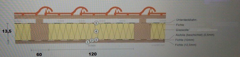

This is how it looks in reality.
Currently, there is a double wooden ceiling in the upper floor living area (sloped).

Hello "Maddin",
The main insulation for the living areas is probably located beneath the walkable crawl space. The necessary vapor retarder is also installed there.
The vertical surfaces of the roof slope are either not fitted with a vapor retarder, as can be seen, or the aluminum foil facing is not verifiable for airtightness at the adhesive joints to ensure functionality.
My suggestion: If the roof area visible in the photos is only used occasionally and not for regular living purposes, and (this would need to be checked) there is an insulation layer including a vapor retarder installed beneath the crawl space, then a polyethylene (PE) film applied to the roof slopes could help improve wind tightness and prevent the insulation material from falling into the room if it is not properly secured.
The main function of the vapor retarder would then lie in the crawl space area (or the ceiling of the room below), so no additional vapor retarder would be necessary for this reason.
(This advice is given without knowledge of the site conditions, therefore it does not constitute a build recommendation.)
Best regards, KlaRa
Best regards, KlaRa

Hello "Maddin77".
What you are (unconsciously) planning here is a limited and adapted use to accommodate the poor execution of the interior insulation (assuming it is indeed between the upper floor ceiling and the insulation) where no vapor retarder was installed.
Now, if the insulation layers on the roof slopes do not allow any thermal bridges and the insulation fits tightly everywhere, then the vapor retarder can be safely installed on the room side. However, the polyethylene foil should be sufficiently thick (at least 0.15mm (0.006 inches)) and the joints of the sheets must be tightly overlapped and sealed with strong adhesive tape.
It becomes difficult at the transition to the floor (some kind of connection has to be made there) and also at any existing window openings.
As soon as the construction, consisting of insulation plus vapor retarder, allows moist and warm air from the underlying floor to penetrate the insulation layer, condensation can occur in winter due to dew point undershooting.
Therefore, the rule is: if you insulate on the inside, you need to know exactly what you are doing!
Best regards, KlaRa
Best regards, KlaRa
