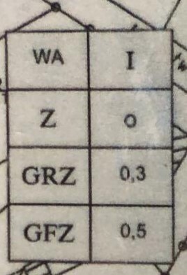

Good evening,
since I have already seen several development plans, I am wondering what the “Z” might mean!?
Detailed development plan: parcels, buildings, streets; playground and zone values WA, GRZ, GFZ.
WA – general residential area OK
I – single-story construction OK
o – open building layout OK
site coverage ratio – 0.3 OK
floor area ratio – 0.5 OK
but what does “Z” mean – ?
No, unfortunately, I don’t have the legend for the development plan at hand
and there is nothing about it in the zoning regulations either.

Scout schrieb:
Well, Mr. Trump Jr., you still lack a lot of the necessary skills and experience for the intended career change to a property tycoon.
My tip: "Z" = construction method, "o" = open
What does that mean?
And? Z = construction method???
o = open construction method! Got it already
Scout
28 Jan 2020 11:42
if it is as I think.
“Open construction,” no continuous groups of buildings longer than 50 meters (164 feet). So detached single-family houses, semi-detached houses, and row houses. Possibly also apartment buildings.

Open construction is open construction. But what does the Z in the land use template mean???
L
ltenzer
28 Jan 2020 12:00
RaBa2020 schrieb:
Open construction is open construction. But what does the Z in the usage template mean???
Perhaps a relic from a past time when the building authority marked the “Z” allowable building method with the same letter? And neighboring building zones are newer and therefore no longer receive a “Z”?

So, today I called the planning department of the building authority to inquire about the template and the "Z". The "Z" still refers to > permissible number of storeys and is an error within the usage template.
