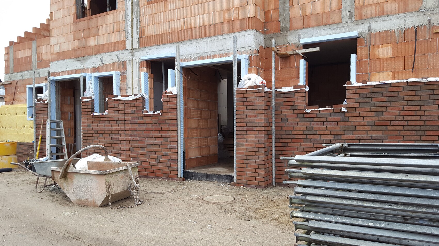

Is the house left without insulation during this period, or how is the weather-sensitive insulation (usually mineral wool) protected?
In our case, the ground floor is now complete, with the ceiling installed, and at the same time the upper floor is being built with masonry while the ground floor is being faced.
So, on the upper part (upper floor at the gable) only the wood is visible from the outside so far, and on the ground floor there is some kind of black foil additionally applied. I can’t tell you exactly what that is, but there are probably differences between prefabricated construction and solid construction anyway?
opalau schrieb:
Is the house left without insulation during this time, or how is the weather-sensitive insulation (usually mineral wool) protected?
For us, the ground floor is now finished, the ceiling is on, and at the same time, the upper floor is being built and the ground floor is being clad. I guess it will be exposed then.
The field representative said, in response to my question, that this is completely harmless.
