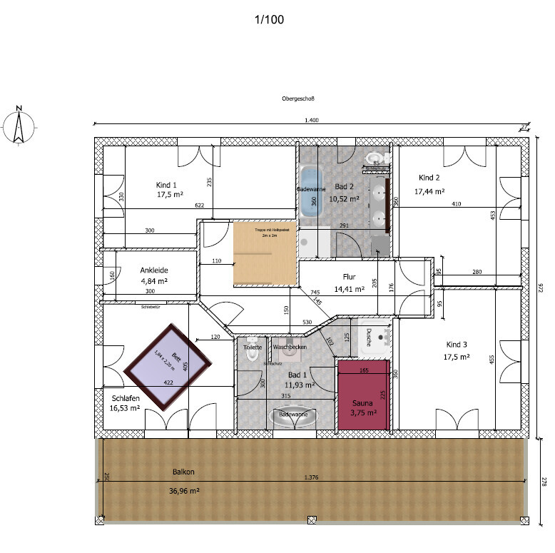

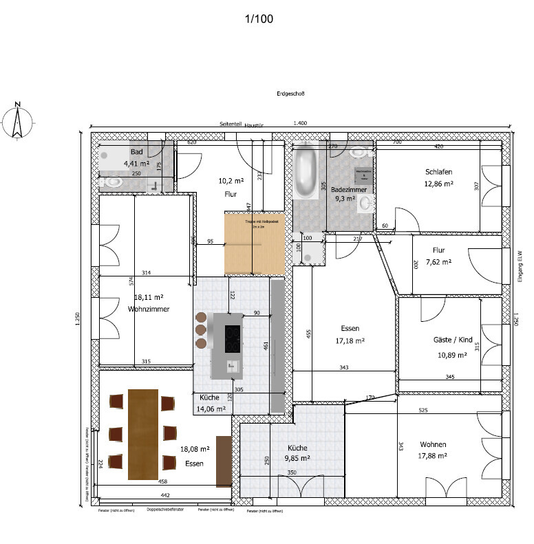

Hello Forum,
Here are the key details so far; any updates will be added. The design was created using SweetHome 3D.
Plot size: 750 m² (8,070 sq ft)
Slope: south-facing slope approx. 25%
Site coverage ratio:
Floor area ratio:
Building envelope, building line and boundary: W 21 m x D 14 m (69 ft x 46 ft)
Edge development: yes
Number of parking spaces: 3
Roof type: gable roof
Architectural style:
Orientation: ridge line parallel to the street
Maximum heights / limits: ridge height max. 12 m (39 ft), eaves height 7.5 m (25 ft), valley side 7.5 m (25 ft)
Additional requirements: construction on the slope side
Homeowners’ requirements
Architectural style, roof type, building type: wooden house
Basement, floors: basement / garage
Number of occupants, ages: 5 persons, 2 adults + 3 children (10, 12, 15 years)
Room needs on ground floor, upper floor: see plan
Office: family use or home office? no
Guest bedrooms per year:
Open or closed architecture:
Conservative or modern design:
Open kitchen, kitchen island: kitchen island
Number of dining seats: 6
Fireplace: no
Music / stereo wall: no
Balcony, roof terrace: balcony
Garage, carport: 3
Utility garden, greenhouse: not yet planned
Other wishes / special features / daily routines, reasons for choices: We need a separate apartment with at least 75 m² (807 sq ft) for 3 persons
Who designed it:
- Do-it-Yourself
What do you dislike? Why?
Price estimate according to architect/designer:
Personal price limit for the house, including fittings: 600,000 €
Preferred heating technology: underfloor heating
If you have to make compromises, which details / extensions
- can you do without: open to suggestions
- cannot do without:
Why is the design the way it is? For example:
Since we absolutely need the separate apartment, the design grew in size, and after 5+ drafts, this should now be the final version
What makes it, in your opinion, particularly good or bad?
Can the design be slightly reduced without losing rooms?
I hope nothing is missing—otherwise, please contact me.

That said, the design is simply poor, sorry. There are people here (like Kaho, for example) who, although not professionals, come up with good designs—they have a knack and a feel for it. Others don’t. It takes a lot of experience. You’ll meet people here who have been around for years because they enjoy (myself included!) working on floor plans. You see a lot, including enthusiastically presented layouts from people who might be great cooks but should really leave floor plan design to someone who knows what they’re doing. There are also people who burn water—wouldn’t want to go to dinner at their place either... Some people just have a talent for design. Here we definitely see both good amateur designs and poor professional designs. Or bad designs from general contractors trying to adapt their standard plans to their clients’ needs with minimal changes, often making things worse. We’ve seen it all here.
But: if you ask for feedback here, you should also accept it. For this design, you’re unlikely to get good feedback. I say this as a non-professional but an experienced forum member.

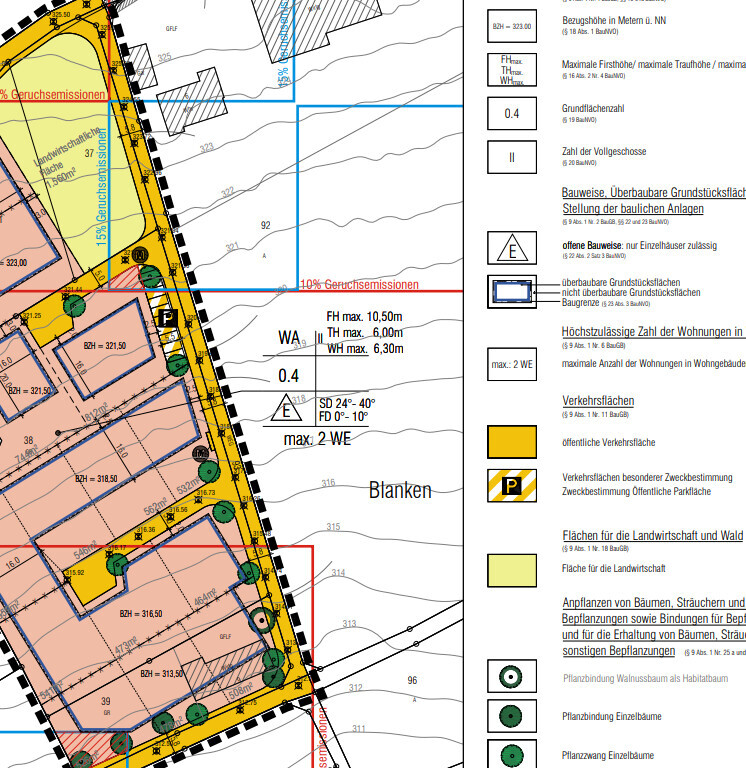

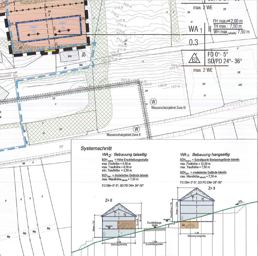

Building envelope, building line and boundary B 21m x D 14m (69 ft x 46 ft)Where is the slope taken into account in your design? Location plan missing.N
nordanney13 Jul 2020 11:31This is what a development plan looks like. In this case (from Forchtenberg), a floor area ratio of 0.4 is specified, meaning that 40% of the plot may be built on (including driveway, terraces, garages, etc., although there may be other calculation methods). You will also find information about the allowed number of floors, ridge heights, and other details.
If you want to build two stories, you have to be permitted to do so.
Anson Argyris13 Jul 2020 11:33I appreciate and welcome the feedback. After reviewing the plan again in light of the maximum buildable area, I have to admit that the plan is basically useless.
