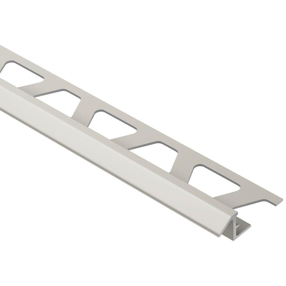

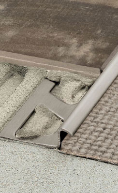

I then did some research online and naturally found the standard transition profiles everyone knows (and that I really dislike). After a while, I came across the Reno-TK profiles from Schlüter, which I find very interesting. Therefore, my question is: has anyone installed these before? Any experiences or suggestions?
Basically, we want the profile to be as thin as possible, flush with the tiles, and with as little overlap as necessary on the laminate side. Do you possibly have alternatives to the Schlüter profiles?
The problem with the Schlüter profiles is that the opening for the laminate only has a total height of 6mm to slide it under; the only option might be to bend it slightly so the laminate fits underneath...
Attached are two pictures of the Schlüter Reno-TK profiles.

this Schlüter profile Reno TK does not work with laminate flooring. Even if you could insert the laminate under the "lip," the horizontal gap (expansion joint to the tile) would be too narrow.
The Reno V profile might be suitable. I haven’t seen it in person, but based on the cross-section drawing, there seems to be enough space for the laminate to expand.
Alternatively, multi-piece profiles from the company Kügele could work. Of course, any other manufacturers with similar systems would also be an option.
