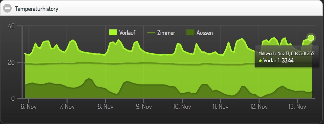

Yesterday, I had to raise the heating curve to 0.5 because my wife complained that the house was not getting warm enough. At the current temperatures, this means a flow temperature of about 32°C (90°F).
Do I understand correctly that, theoretically, I could increase the flow temperature up to 40°C (104°F)? It is currently limited to 35°C (95°F).
