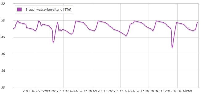

we have built a single-family house and have installed a heat pump (Nibe) with underfloor heating, among other things. Since we are currently gaining our first experience with this technology, I have a question about the flow temperature.
I have noticed that we repeatedly experience short-term increases in the flow temperature. Over 24 hours, there are cyclical rises (about 10 times) up to a temperature of 50°C (122°F), even though the current outdoor temperature is 12/13°C (54/55°F) and the flow temperature specified by the heating curve is 26°C (79°F). Of course, this leads to corresponding electricity consumption. Is this normal? I can hardly imagine that...

Could this possibly be the domestic hot water preparation?
Set the domestic hot water preparation to 1-2 times daily, depending on usage patterns. Hmm, that might be the case, but it doesn’t quite match the analysis of the domestic water preparation. Strange.
