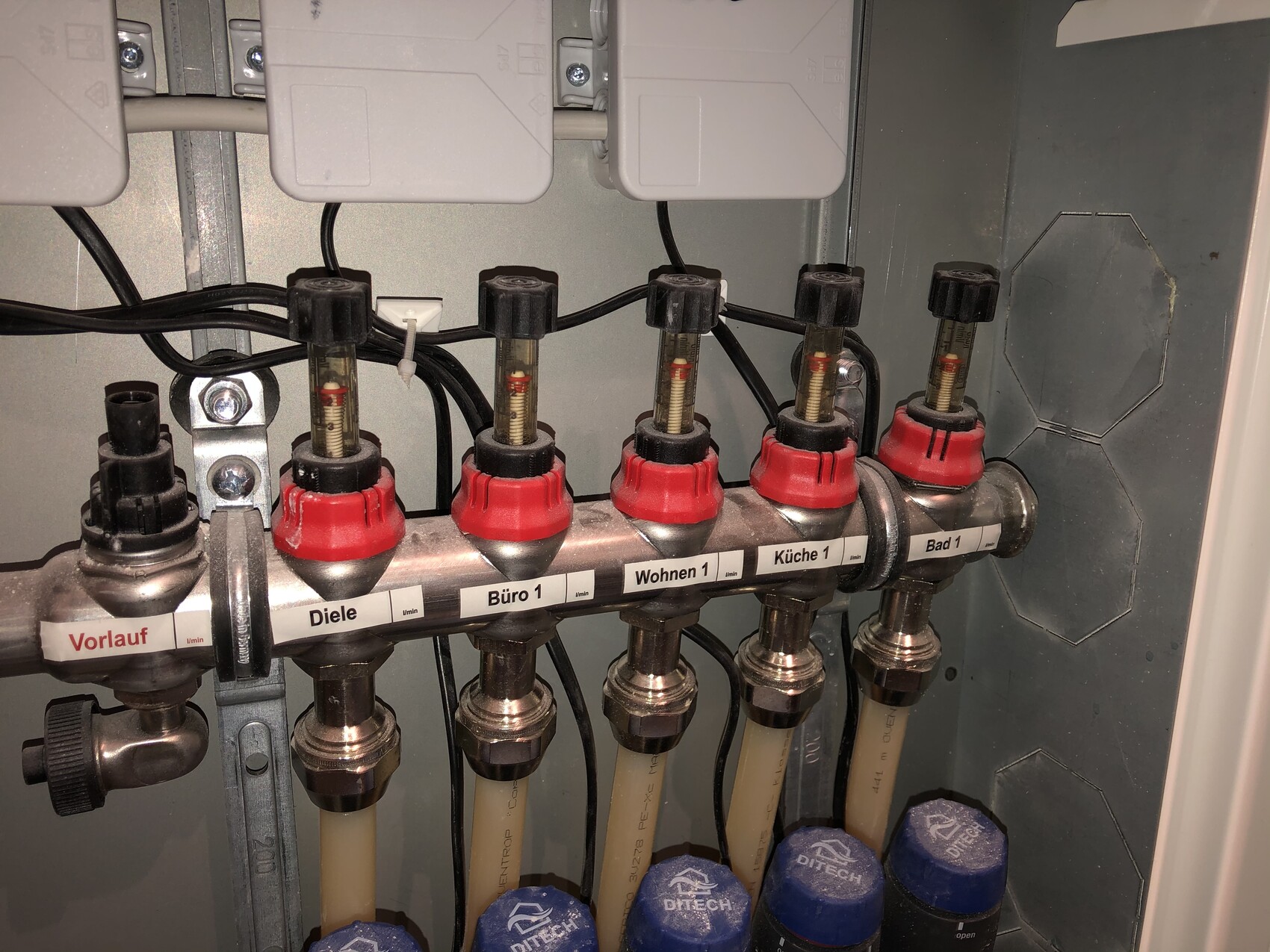

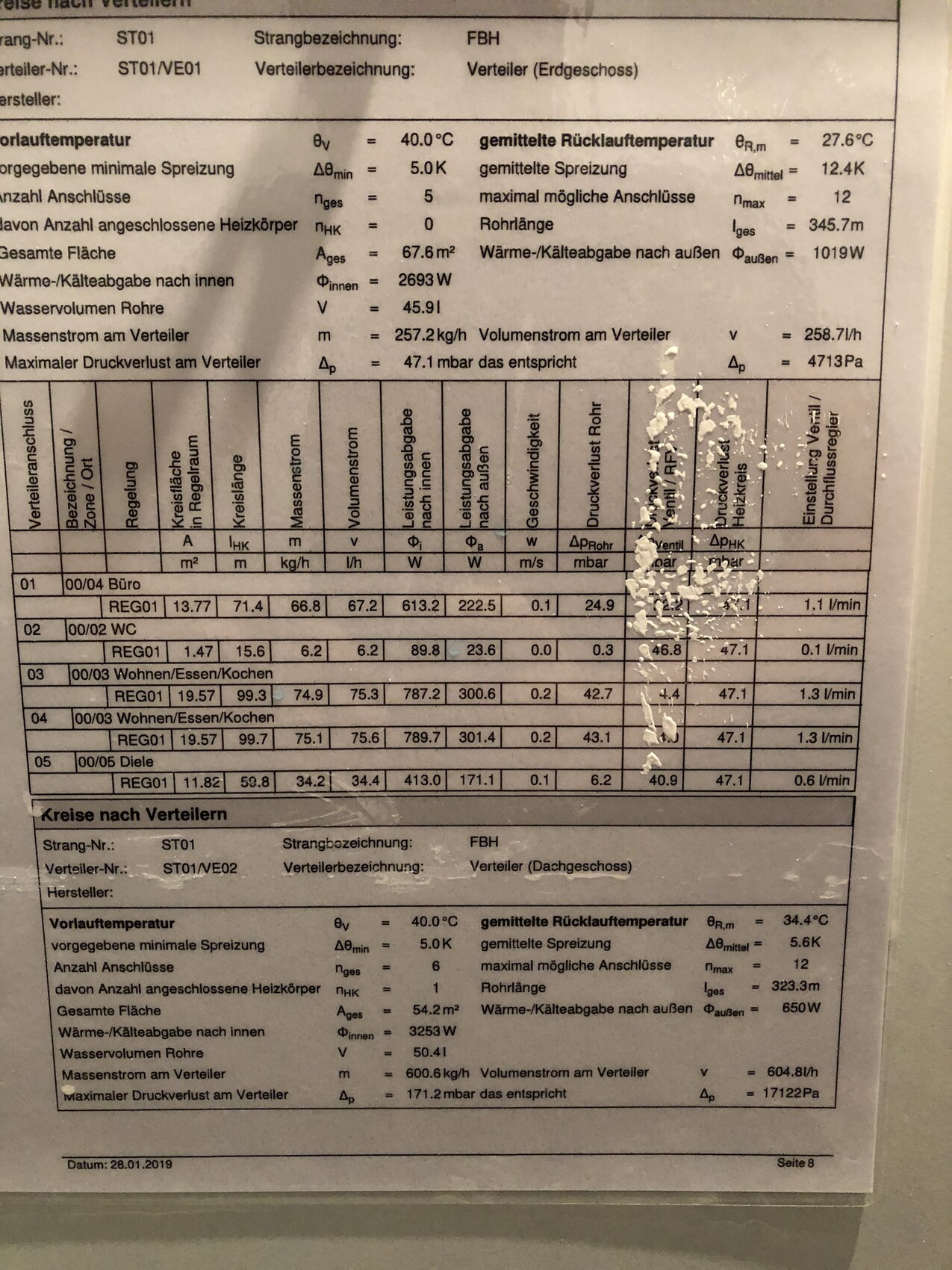

Now I would like the professionals to take a look at this. Either I have no idea what I’m doing, or everything is simply wrong. Attached are the calculation I found and a photo showing the current situation on the ground floor when all circuits are open.
Hydraulic manifold with red valves; labels: supply line, hallway, bathroom 1.
Manifold pipe with valves; labeled lines: hallway, office 1, living room 1, kitchen 1, bathroom 1
Technical datasheet with measurements: tables, values for temperatures, pressures, and distribution.

I see that a supply temperature of 40 degrees Celsius (104 degrees Fahrenheit) was used, and the toilet is being severely throttled as a result. Follow the hydraulic balancing process. Lower the supply temperature as much as possible! Open as many circuits as possible.

If a system is designed for 40 degrees Celsius (104°F), it will save piping, meaning the pipe spacing can be relatively wide. Is anyone able to calculate this backwards or does anyone know approximately how much pipe per square meter corresponds to which pipe spacing?
Requests to reduce the supply temperature are suddenly limited when pipes have been installed everywhere at only 20 or 25 centimeters (8 or 10 inches) spacing.

Here the question is theory versus practice. I wouldn’t calculate anymore, just do it. Always keep a record before and after.
Theoretical considerations won’t help here.

For this, you would need the area of each room. Then you could already estimate the VA...
€: For VA 15cm (6 inches), about 5.8m/m² (meters per square meter) are needed; for VA 10cm (4 inches), it is already 8.8m/m². This is, of course, only approximate but should be enough to estimate the VA.
