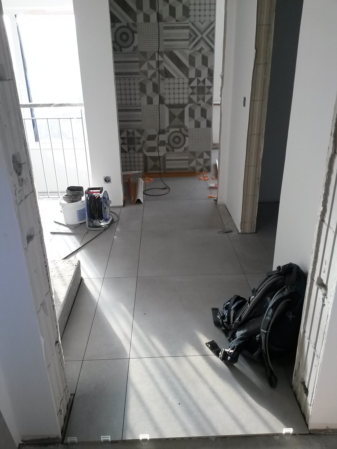

Our tiler is using a tile leveling wedge system, and it works great! We are building with a general contractor, but excluded the tiling work because their tilers only knew tiles up to 60 cm (24 inches) and were significantly more expensive (easily +10,000 EUR overall).
Under the floor tiles, there is an inverted T-shaped tab that stays in place and has a predetermined breaking point, allowing the tiles to be leveled using the wedges. You can see this in the last picture, at the edge in front. The result is perfectly grouted! No uneven or raised corners.
Tile size is 75.5 x 75.5 cm (30 x 30 inches).
We pay for thin-set floor tile installation, 75.5 x 75.5 cm (30 x 30 inches), including the leveling system, a net price of 43.75 EUR (gross 52.06). An additional charge for installing floor tiles on walls is 4.30 EUR net. The tiles (from Saime) cost a favorable 29.12 EUR net after negotiation, minus 2% discount. With 180 m² (1,937 sq ft) of floor tiles plus 45 m² (484 sq ft) of wall tiles in bathrooms, we received a slight discount. Including adhesive, grout, thresholds, baseboards, stainless steel strips, and other extras, the total quickly exceeds over 120 EUR gross per m².
