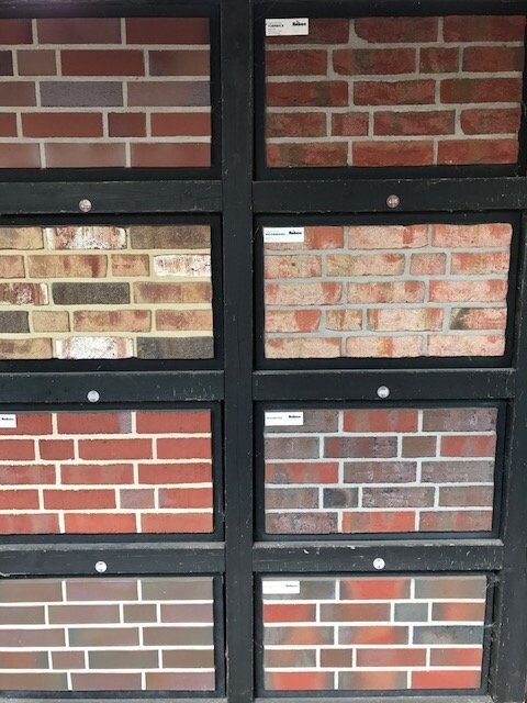

We have now scheduled an appointment with a building materials supplier to explore various options. Afterwards, we will try to get reference addresses, because you can’t really tell what the final effect will be from sample boards (as shown in the attached picture). Maybe by then we will also have the chance to choose the next step – the joint color.

Afterwards, we will try to get reference addresses Yes, as a layperson it’s easy to misjudge the overall effect. In your sample panel photo, the joints all seem too thickly filled to me. It’s better to get reference addresses where the same contractor worked—so not from the building material supplier with a different contractor.
