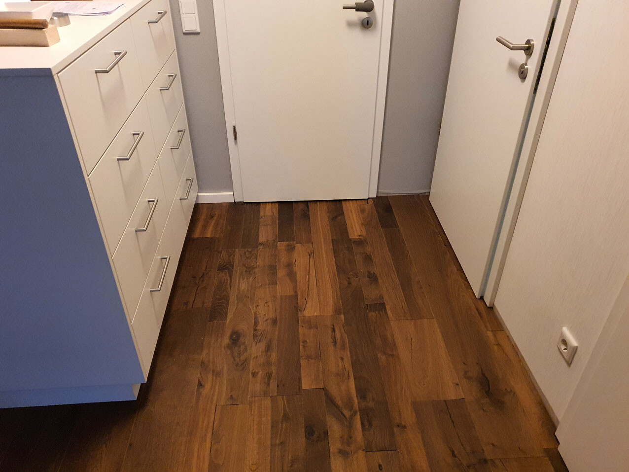

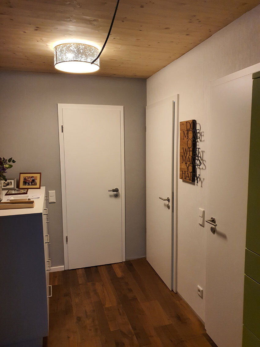

pagoni202013 Nov 2021 11:27ateliersiegel schrieb:
Lately, I've often been thinking about how "neat" a house needs to look for the residents to be satisfied.I believe this is very individual, and it’s important to stick to your own taste. There is a social pressure that affects all of us to varying degrees. The skill lies in drawing inspiration from outside without letting it dominate. We have just finished installing our hardwood floor, and because of the color pigments applied, every scratch and tiny sanding mark shows up clearly. Looking closely at the details, you might call it “worn,” but overall it resembles a pub floor where a new dent never really stands out—it just belongs.
I was curious and a bit uncertain at first, but now I’m quite happy with it. Still, this style probably isn’t for everyone. And yes, it sometimes creaks and will develop gaps, even though we installed it tightly. I’m familiar with that and actually appreciate it because I know I’m walking on 30mm (1.2 inch) solid wood, which I personally like a lot.
Both previous contributors have made many valid points. I feel similar about my flooring; however, I was quite upset for about half a day when the first deep, clearly visible scratch appeared (caused by someone else who did not own up to it). After that, I caused smaller marks myself and stopped getting annoyed about it 😎. My floor (15mm (0.6 inch) click-lock oak parquet on 18mm (0.7 inch) OSB, with 1.5mm (0.06 inch) impact sound insulation in between, and wooden joists beneath insulated with rubber granule mats) creaks and makes noises but feels extremely soft and flexible. Fortunately, it turned out exactly as I wanted, and when I put my feet on this beautiful floor first thing in the morning, it gives me an extremely good feeling.

pagoni202013 Nov 2021 12:08We screwed the floorboards onto floating timber battens with 5mm (0.2 inch) insulation strips in between, and added wood fiber insulation between them. Often, we wished the wood wasn’t so unpredictable, as wide and long solid softwood planks don’t always like being checked with a straightedge. The good thing was that in some spots, we simply screwed a screw directly into the plank from above, and everything looks just as intended (to us 😉).
Basically, it’s like with my old car. Recently, when a truck bumped into it, we had a short conversation and parted on good terms without any claim for damages from me. I would have surely felt and reacted differently if it had been a sleek, polished new car. In that sense, a rather rugged floor is a bit more relaxing.
We had moved our refrigerator on furniture casters and later noticed that the casters had made indentations in the floor. The solution....... the dining table will be placed there anyway :-)
In addition: after a few days, the indentations disappeared again; apparently, the indoor humidity helped, and the slight dents are actually gone — at least I can no longer see them, which is really all that matters!
