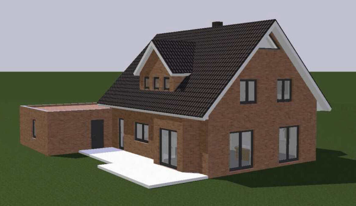

We are currently in the middle of the construction phase (the ground floor is completed, and we are waiting for the floor slab of the upper story).
Our house will have a simple gable roof oriented ENE-WSW (east-northeast to west-southwest) with two extensions, so there will be relatively little space left on the roof for a photovoltaic system (additionally, there will be a solar thermal system installed there as well). Our garage is located north of the house, so the building would block the sun from that side.
I recently came across solar terrace roofs and would appreciate it if anyone here has experience with them, both positive and negative:
Our terrace faces northwest, so it would naturally be shaded from direct sunlight until midday.
The theoretical maximum area available would be about 11m x 3.5m (36ft x 11ft).
If you need any further details, I’d be happy to provide them...
