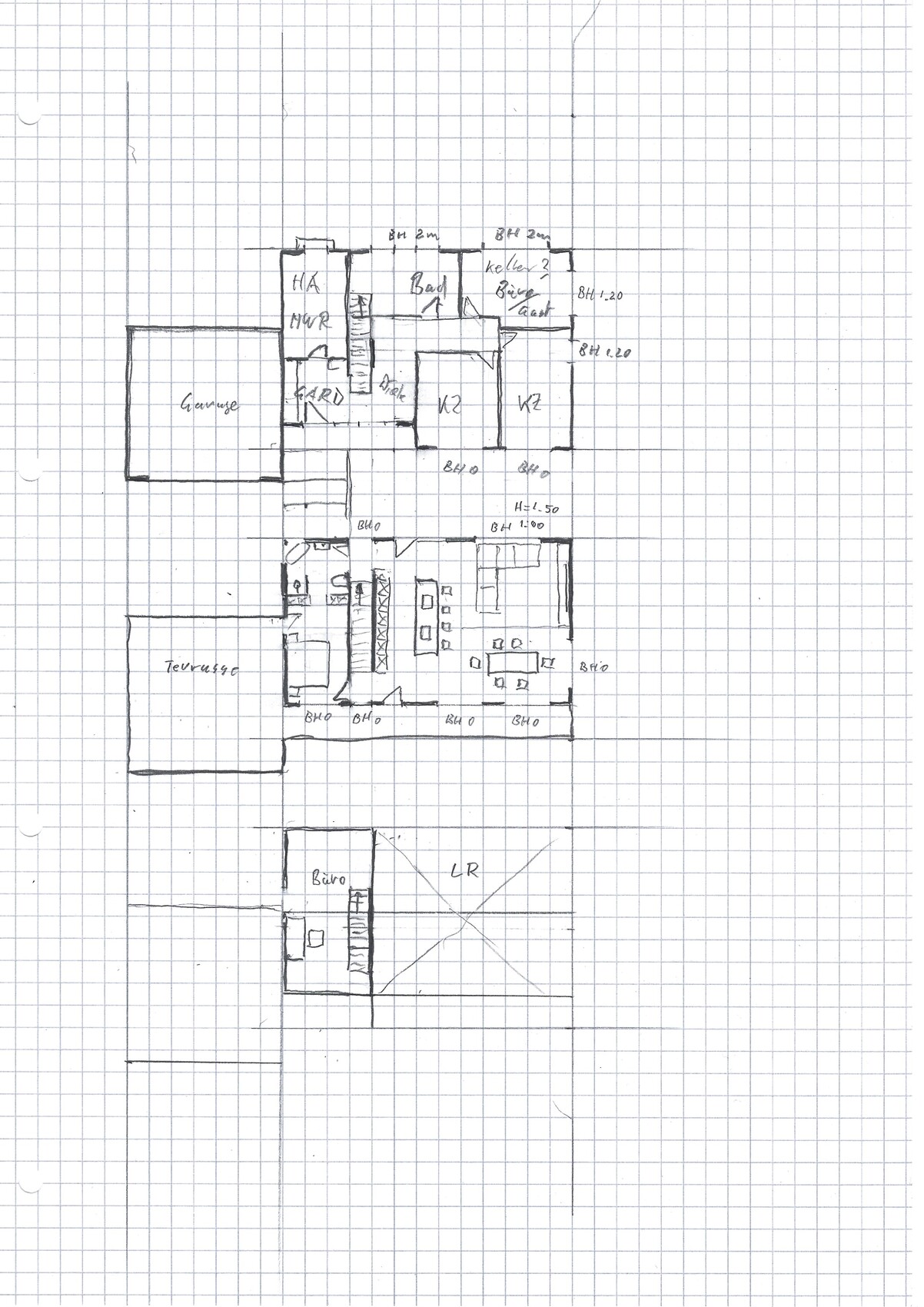

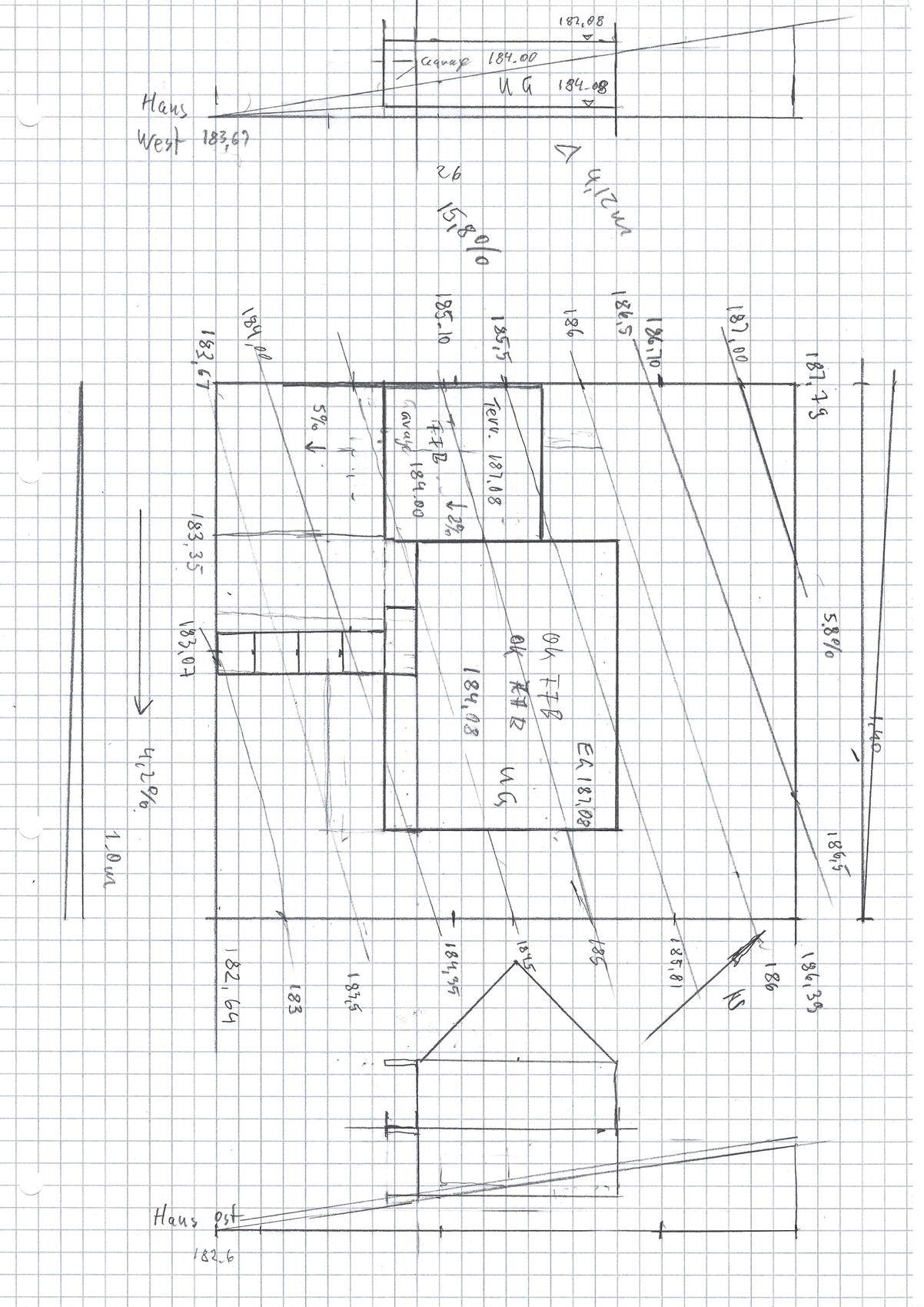

Has anyone here built a house without a basement on a slope? I would appreciate some pictures to get a better idea. We have an elevation difference of about 5 m (16 feet) from the street to the property boundary, which is approximately 25 m (82 feet) away, and the finished floor level (FFL) is planned to be 1.66 m (5.4 feet) above the street, with the garage 0.5 m (1.6 feet) lower.

Did you plan with an architect or general contractor?
Timber frame?We planned with an architect/structural engineer. We are building with solid masonry, stone on stone. We are doing the entire shell ourselves, and for the trades we don’t handle, we contract them out ourselves.Then I understand the planning even less.
For us, it is similar to a giant L-shaped concrete block. The foundation slab and retaining wall are connected with a large amount of steel reinforcement within waterproof concrete. The retaining wall holds back the slope. Below is the main garden, and above, behind the house, there will also be a terrace on ground level. (Maybe this year, we’ll see.) Except in the morning, the only sun there comes from above the house during summer. In that case, the 5 m (16 feet) might be tight.
