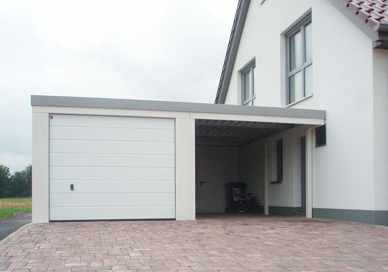

About the garage:
We also considered a double garage. However, our plot is rather small at 436 m² (4700 ft²). My wife is concerned that a double garage would visually close off the property, so we wanted to go for a combination of an extended single garage plus a carport with a connection to the house. The main entrance is also conveniently located on the side, so we can always enter the house and garage without getting wet. This means the entrance canopy is effectively “free.”
Something like in the attached picture.

Your wife is absolutely right. A garage instead of a garden is a bad idea for such a small piece of land.
