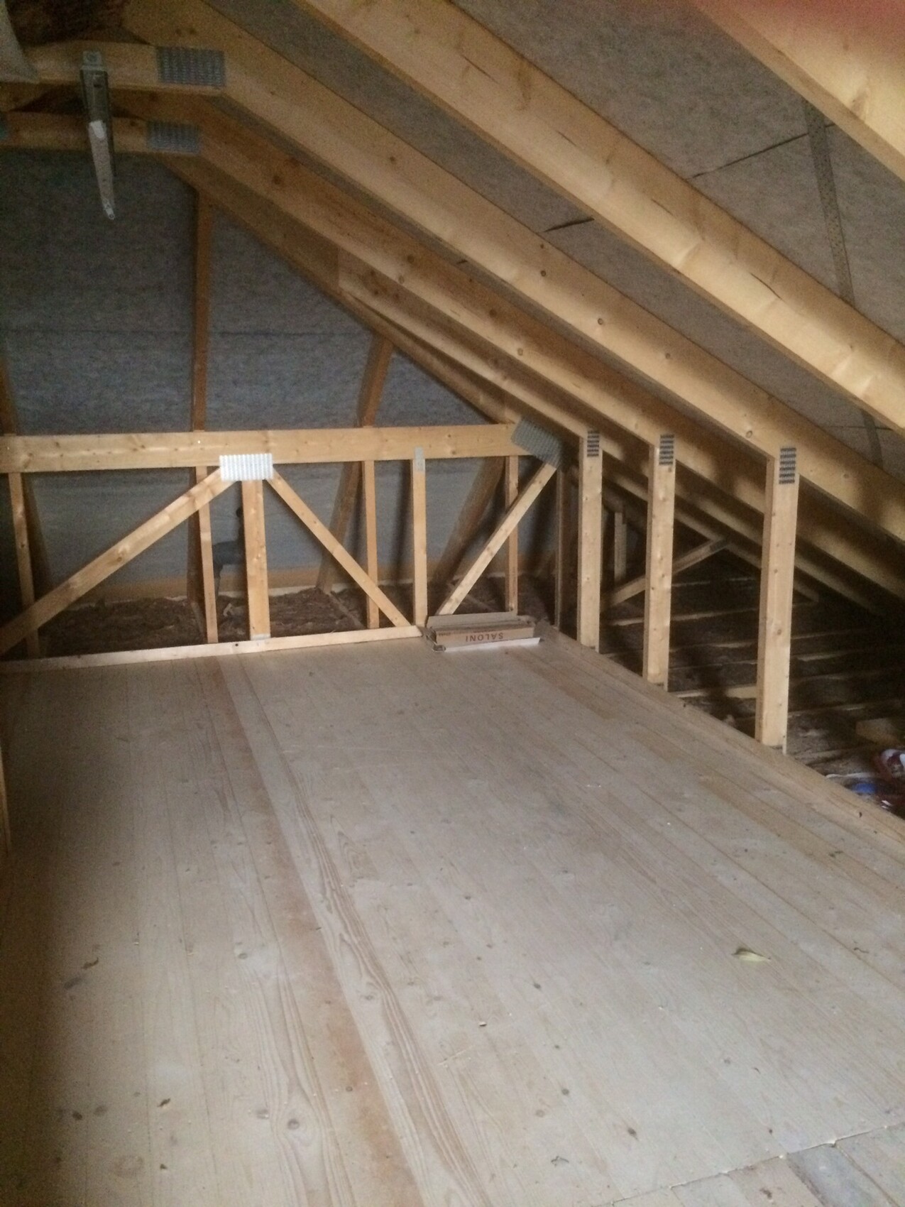

Without being too forward: Would you be willing to share 1-2 pictures of your attic? I’d like to get an impression of the actual space available.
Maybe this helps a bit. The house dimensions are roughly the same as yours, but the roof pitch is lower. We have about 1.75 m (5 ft 9 in) of standing height in the middle. Otherwise, you can see roughly half of the floor area here. At the back in the shadow, there’s an additional length of OSB boards, about 2.25 m (7 ft 5 in), which you can’t see.
Attic shell construction with roof truss, insulation, and visible wiring.

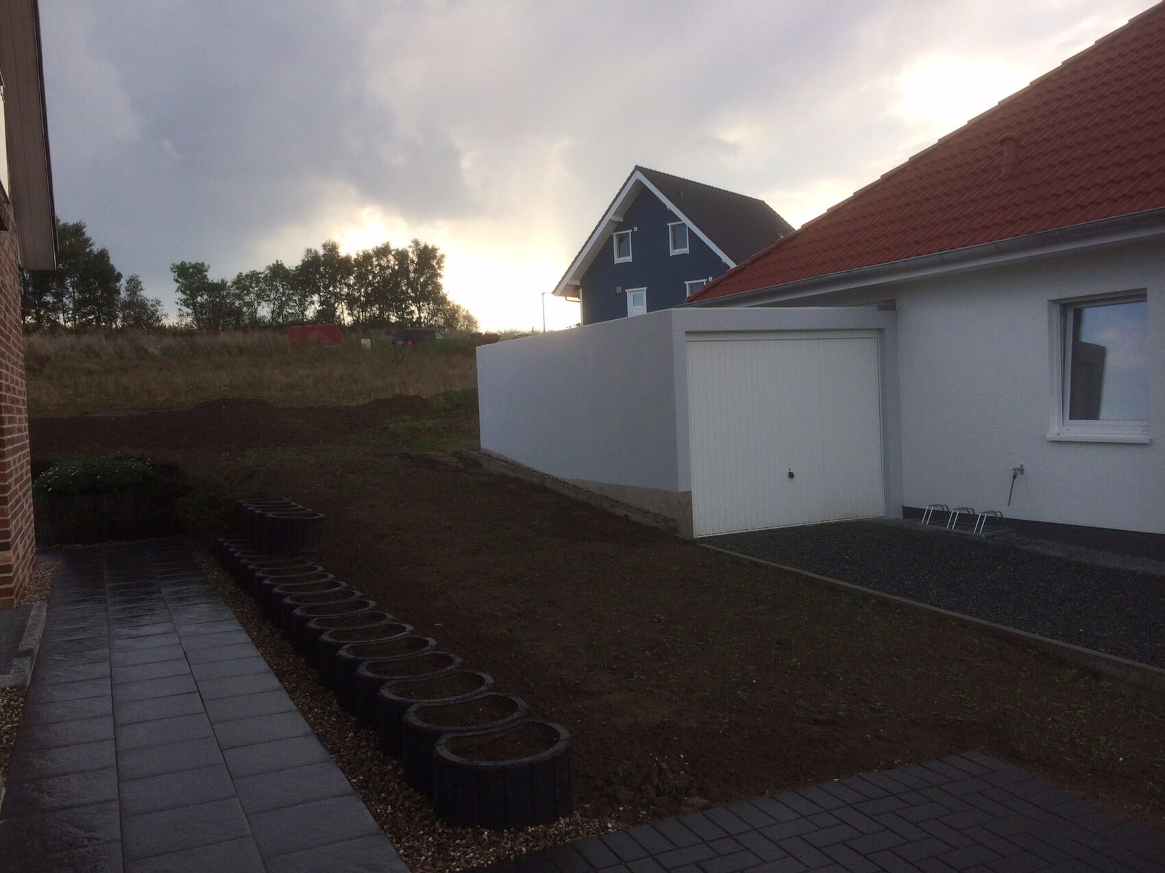

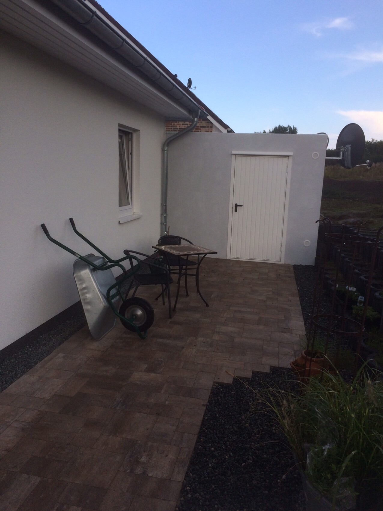

Consider why you really need a car in the garage. It is painted and galvanized and can withstand outdoor exposure well. You save money by turning a standard 6 by 3-meter (20 by 10-foot) garage into a great garden shed, storage room, or workshop area, leaving the car outside. Attached are pictures for illustration. Karsten
