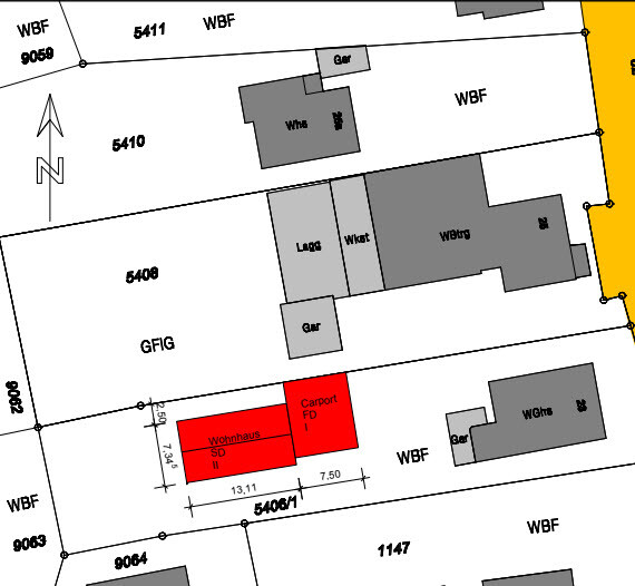

Hello dear house building forum,
we are planning to build a single-family house on a part of the parents’ property. The plot still needs to be separated and then connected to utilities. Currently, the main focus is on the floor plan. The kitchen faces north. The large living room window faces south. The entrance area is on the east side.
Please take a look at the floor plan and we would appreciate honest feedback! Thank you in advance!
Development plan/restrictions
Plot size: 450 sqm (30 x 15 m)
Slope: no
Building envelope, building line, and boundary setbacks: 2.5 meters (8 ft) on the long side, 6 meters (20 ft) on the narrow west side, boundary construction possible on the east side (adjacent to parents’ property)

First of all, many thanks for your input.
This was planned that way in an initial design, but we decided on the kitchen in the northwest because we wanted a short route from the kitchen to the outdoors. The terrace borders the west side, and we wanted to keep the walking distance short there.
We are currently trying to find a solution for this. At the moment, we are considering a sliding door toward the entrance hall.
I think the utility room will probably remain in the main laundry area.
That is a very good suggestion; we will revise the plan in this direction. Children’s bedrooms on the gable ends and the utility room between them.
1.60 meters (5 feet 3 inches)
Thanks for the tip!
kaho674 schrieb:
With the usual layout, you would first expect the kitchen after the entrance hall.
kaho674 schrieb:
The cozy area fits much better in the north/west corner and is also much more comfortable if it can’t be seen directly from the front door.
The utility room in the area where most laundry accumulates makes sense – but if you don’t want it there, it should be planned differently.
wrobel schrieb:
Place the two children’s bedrooms on a gable wall since the side-positioned windows are very low. Nobody really needs the lounge area in the upstairs corridor, so add that space to the children’s rooms. If a storage room is also needed, put it between the children’s bedrooms.
What was the knee wall height in the house?
kbt09 schrieb:
With a ceiling height of 302 cm, I would also double-check the stair rise dimensions.
Thanks for the tip!
