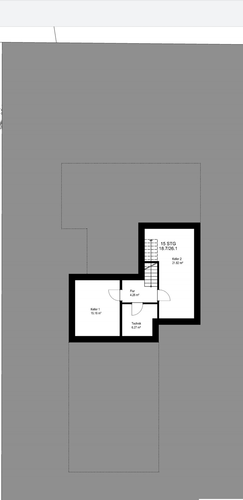

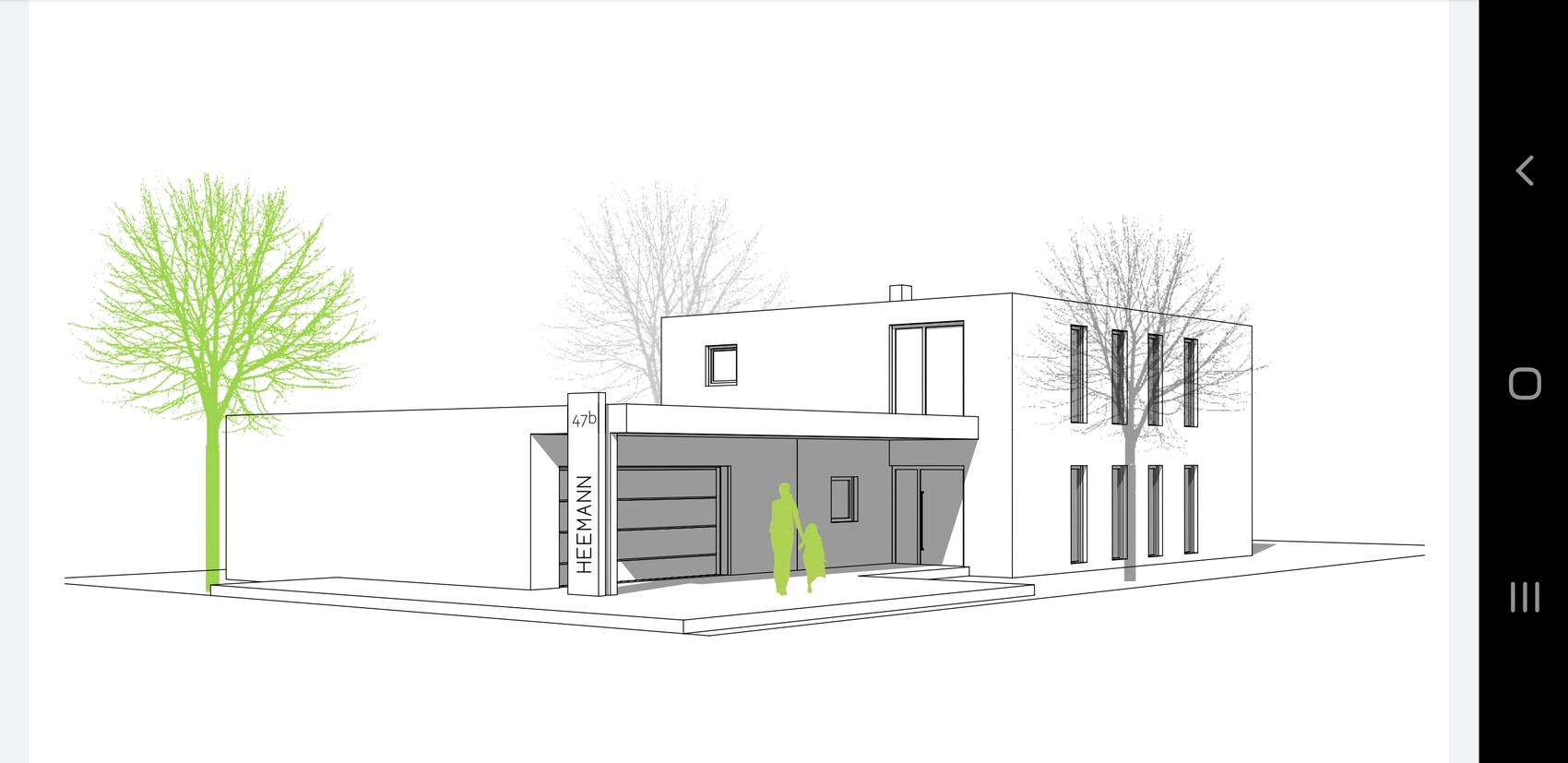

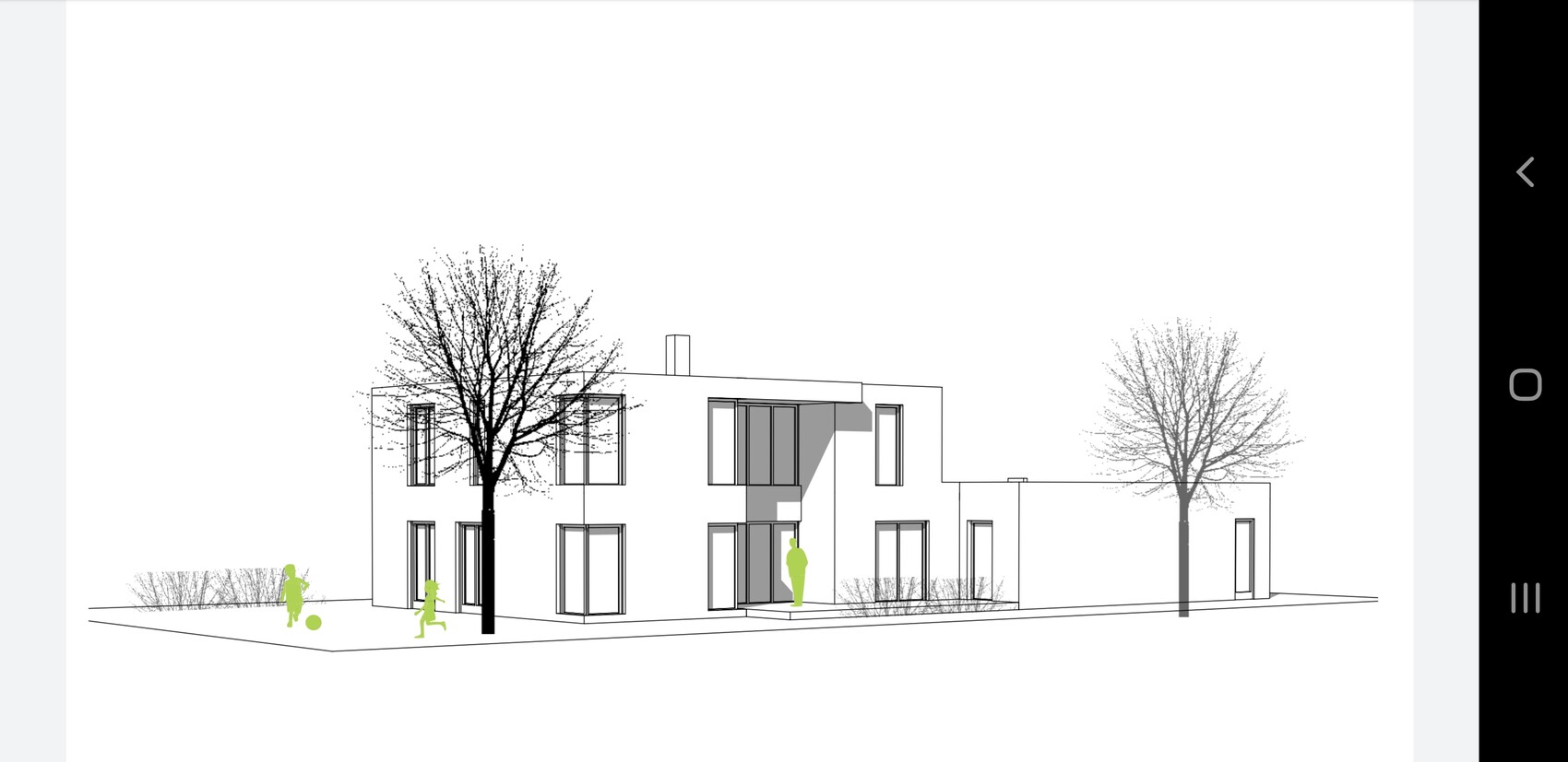

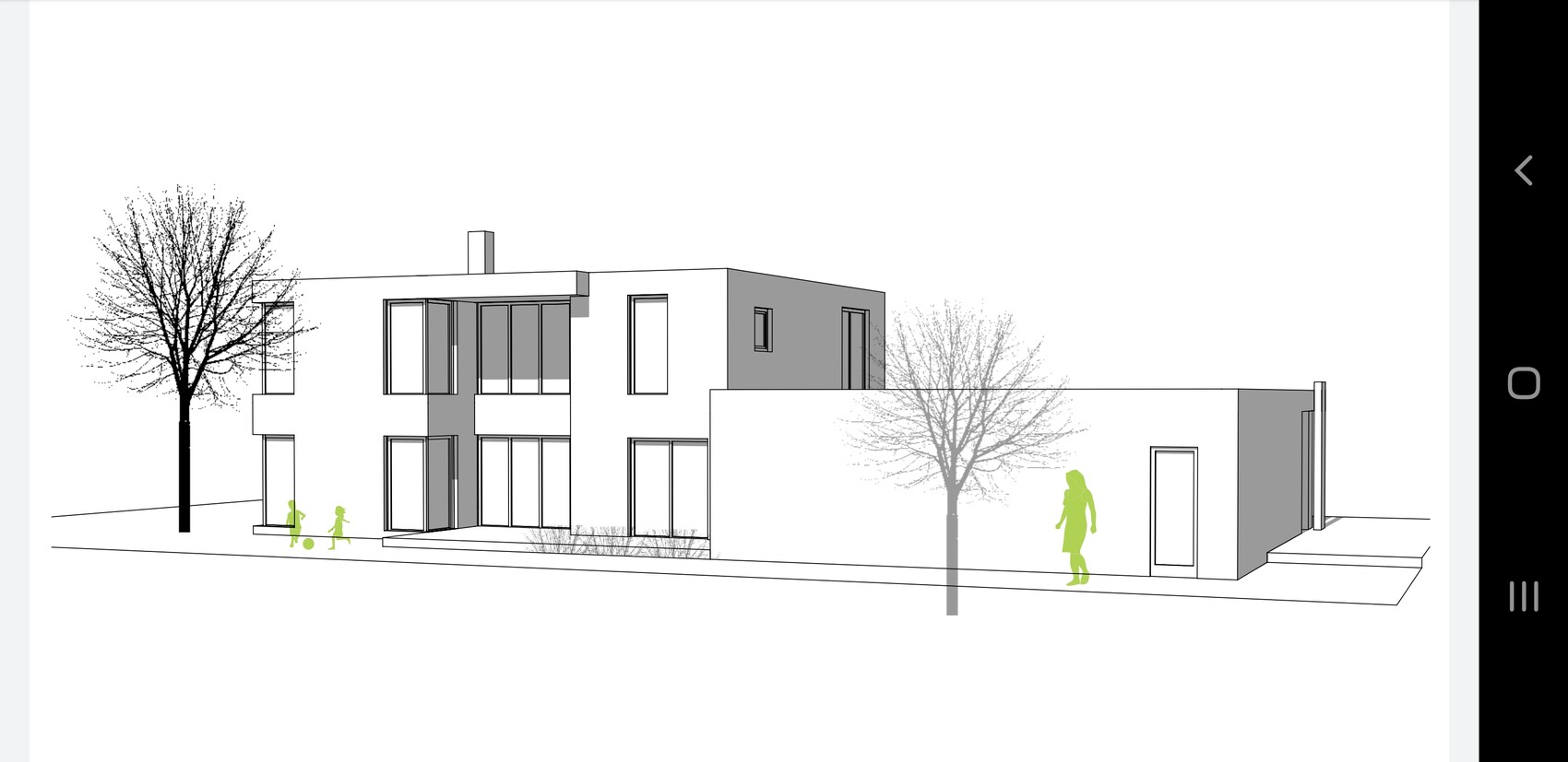

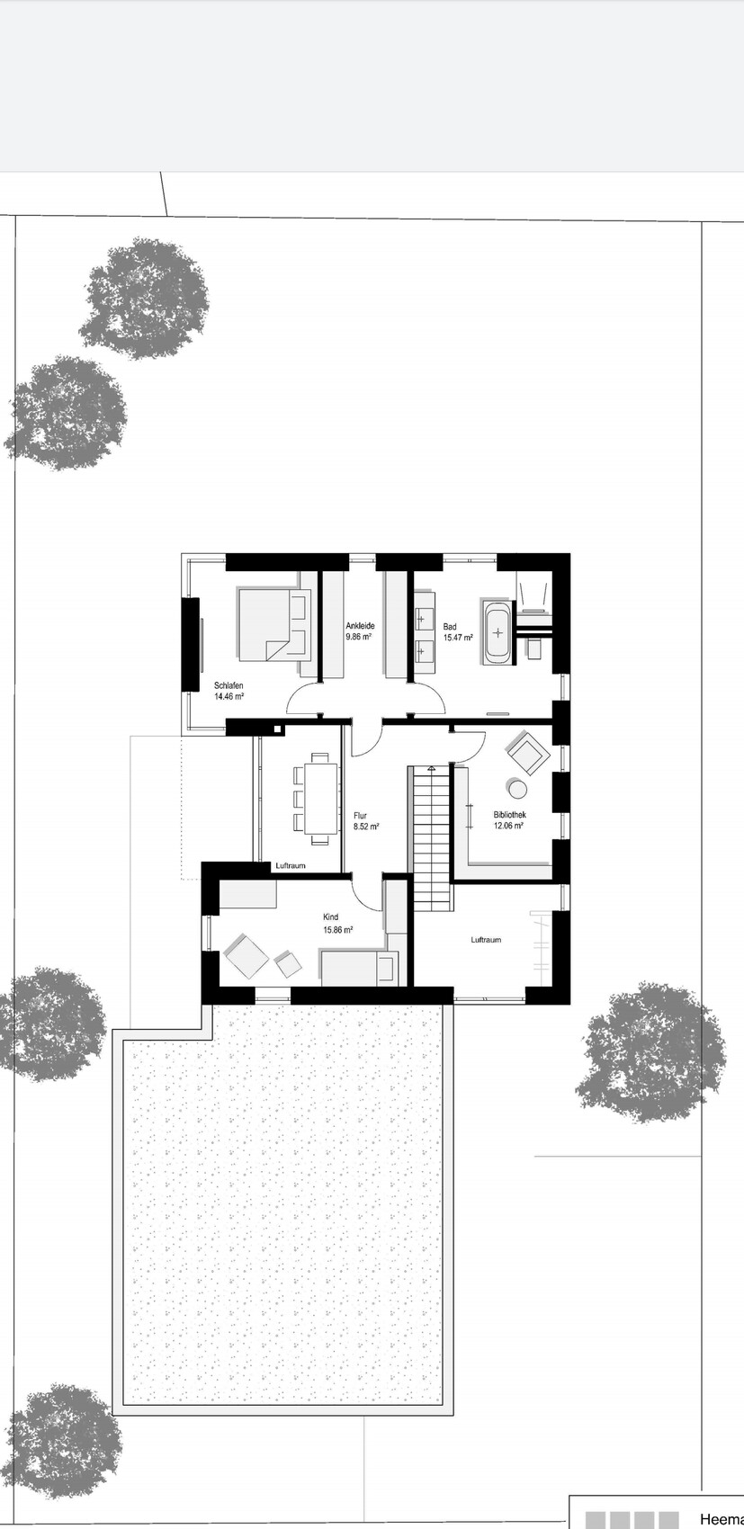

ᐅ Single-family house in Bauhaus style with flat roof, 2 full floors plus basement
Created on: 1 Mar 2021 15:41
L
Lheeman
- No formal development plan. Construction governed by §34 Federal Building Code
- Plot size 700 sqm (7,535 sq ft)
Requirements from the Homeowners
Style: Bauhaus
Roof type: Flat roof
Building type: Single-family house
Basement: Yes
Floors: 2 full stories
Number of occupants, ages: Currently 2 (31 and 33 years old) + 1 child later
Space requirements on ground and upper floors: at least 180 sqm (1,938 sq ft) of living space
Office: Family use or home office? Both
Overnight guests per year: 0
Open or closed architectural style: open
Open kitchen, kitchen island: both
Number of dining seats: at least 6
Fireplace: yes
Music/stereo wall: home theater to be added later (Dolby Atmos)
Balcony, roof terrace: not required
Additional wishes / special features:
- Photovoltaic system with battery storage
- Basement to be convertible into home theater
- Increased ceiling height on ground floor. Usable height of 2.8 meters (2.55 m (8 ft 4 in) in upper floor)
- Ventilation system
- Ground floor designed for age-appropriate accessibility
- Access to terrace from dining area via fully folding sliding door to extend dining space into garden
- Plot borders a busy street to the south
Designed by:
- Architect
Cost estimate according to architect/planner:
€586,000 (approximately $635,000) without basement (€70,000 (approximately $76,000) for basement), land is extra
Personal budget limit for house including fittings:
€600,000 (approximately $650,000)
Preferred heating system:
Air-to-water heat pump with underfloor heating on all levels
If you have to give up, which details/features
- can you give up:
- basement
- open space with gallery
- cannot be compromised:
- increased ceiling height
Why did the design become the way it is?
We wanted a modern house that can still be used in old age or in case of disability. That’s why we planned a large office/guest room on the ground floor that can later be converted into a bedroom. For this reason, the ground floor bathroom is equipped with a walk-in shower. The exit to the terrace is designed to be level so that it can also be used with a wheelchair. Originally, the house was planned without a basement, so larger storage areas were created in the utility room and garage. The technical equipment will now be moved to the basement. We keep the storage areas upstairs despite having a basement so these remain accessible in old age. The basement might not be accessible in old age.
First, my wife and I are very happy with our architect’s design. Nevertheless, we would appreciate outside feedback. We are open to both positive and negative critiques as long as they are constructive. Maybe someone has useful suggestions for improvements.
Since we will have a fireplace and can obtain unlimited free firewood, maybe someone has ideas on where and how to store the wood efficiently.
