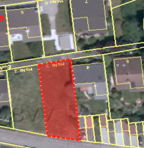

@ypg Most likely, everyone who uses the house will come from the south, including our visitors, since the access road from the south is the usual way to reach us.
I have attached a picture of the surroundings. The pathway basically goes around the two houses to the east and the house to the west. We don’t want to impose that on ourselves or others to have to walk that route every time.
